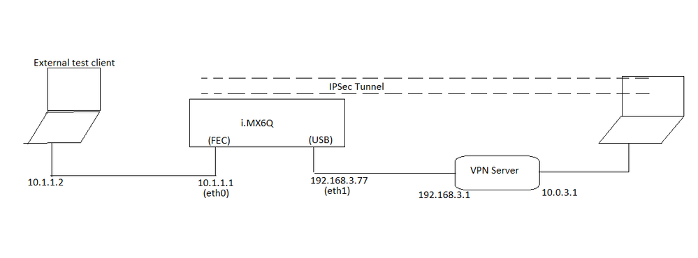

Encryption of IPSEC ESP-packets coming from eth0 ("fec" driver)  fails with CAAM when encryption algorithm is AES or AES256 on Linux platforms.
The sample test setup is as follow:
  • an i.mx6 BSP board (MCIMX6Q-SDB) with 2 network interfaces:
    •    eth0:  attached to the processor, handled in Linux by the fec driver
    •    eth1:  a digitus USB2.0 Ethernet  Adapter (Pegasus/Pegasus II USB Ethernet driver) connected to the OTG port.
  • The board runs the latest linux 4.1.15_1.0.0_ga yocto software with "ipsec-tools" and the necessary ipsec kernel modules .i.e.
CONFIG_XFRM_IPCOMP=m
CONFIG_NET_KEY=y
CONFIG_INET_AH=m
CONFIG_INET_ESP=m
CONFIG_INET_IPCOMP=m
CONFIG_INET_XFRM_TUNNEL=m
CONFIG_INET_TUNNEL=y
CONFIG_INET_XFRM_MODE_TRANSPORT=m
CONFIG_INET_XFRM_MODE_TUNNEL=m
CONFIG_INET_XFRM_MODE_BEET=m
  • The ipsec client on the board  (ipsec-tools) is configured to encrypt traffic in an IPSEC-tunnel from eth0 to a VPN-server behind eth1: the ip traffic comes unencrypted via eth0 and goes out encrypted over eth1. This is a typical "road-warrior" scenario.
  • The esp encryption algorithm chosen is aes (or aes256)
  • In this case CAAM does not encrypt correctly the ESP packets and they are discarded by the VPN-server.
  • It doesn't matter which VPN-server is used, we have been trying with CISCO ASA, various Juniper gateways, PfSense, racoon, strongSwan: problem is always there.
  • We have been replacing ipsec-tools by strongSwan: the problem remains
  • We have been investigating this issue quiet intensively these last 6 months and found out that:
    •   changing the encryption algorithm from aes to 3des solves this issue
    •   deactivating caam also solves this issue
    •   switching cable and ip addresses of eth0 and eth1 also solves this issue
    •   using VLAN tagging on eth0 solves this issue
For different (good) reasons non of these workarounds are acceptable for us: we have a customer that needs to perform IPSEC AES encryption from eth0 to eth1. This issue seems to be present on all i.MX6 platforms.
Are there any workarounds other than the ones listed above for this issue ?
We can provide additional logging/configuration files/images if needed.
Attached is a short description of the IPSEC  test-setup on the i.MX6 test board.

utkarsh_gupta
Have you made any other changes apart from the patches to the kernel? Is this reproducible directly after applying the patches on 4.1.15 release on 6Q board?
12,223 Views
h_eznt
Great!
I will the patches and I give you feedback as soon as I can.
12,223 Views
utkarsh_gupta
Hi, I was able to reproduce the problem finally with all the inputs provided and I see that there might be few patches that might need to apply to make it work.
Please apply the attached patches and let me know if that fixes the issue at your side too.
I have also attached the logs for external client, mx6q encrypting packets and vpn server.
Utkarsh
12,222 Views

Regarding the  VPN-Server configuration on Ubuntu 14.04, you will need the following:
  • install racoon:  sudo apt-get install ipsec-tools
  • and stop it:  sudo /etc/racoon stop
  • configure one interface (for example eth0)  of  the VPN server with ip 192.168.3.1/24
cat /etc/interfaces
  auto eth0
  iface eth0 inet static
  address 192.168.3.1
  netmask 255.255.255.0
  • and restart networking: sudo service networking restart
  • activate ipv4 routing:  sudo su - ; echo 1 > /proc/sys/net/ipv4/ip_forward
  • configure another interface of the VPN server with the  ip 10.0.3.1/24
                This one can be configured manually:
                    sudo ifconfig <yourIfaceName> 10.0.3.1/24;
                    sudo ifconfig <yourIfaceName> up ;
  •   maybe it is wise to deactivate the NetworkManager: sudo service network-manager stop
  • move the  attached  file "racoon.conf.aes"  in the  /etc/racoon/ directory of the  VPN-Server
  • add 2 lines  in the /etc/racoon/psk.txt file  of the VPN -Server as follow
grs.garderos.com     garderos
192.168.3.1    garderos
  • start racoon in foreground with the following commands
   sudo su - ; setkey -PF ; sleep 2 ; racoon -ddddFf /etc/racoon/racoon.conf.aes
Policies don't need to be configured there, they are automatically generated by racoon when the VPN-client connects
Now you are done.
  • You can start to ping from client and check the packets coming in the VPN-gateway with tcpdump: tcpdump -an -i any
12,223 Views
utkarsh_gupta
In addition can you describe if my understanding of your network configuration is correct. If not can you modify and describe it more clearly.
I would need help in creating a VPN server. Should it be through a linux machine running racoon (if yes I would need the configuration files) or is it a VPN through dd-wrt.
Utkarsh
12,223 Views
h_eznt
Your network setup is exactly like mine and you will be able to reproduce the issue with it.
It is not mandatory to have a separate machine on the 10.0.3.0/24 network: pinging from the external test client to the ip 10.0.3.1 on the VPN gateway is sufficient. Please note that you really need an external test client, source pinging from the i.MX6Q will not reproduce the issue (because in this case the packet is directly processed by the kernel without being switched over the eth0 interface).
Basically, you can use whatever VPN-server you want. I would suggest to use an ubuntu  14.04 machine with racoon, since I am not an expert in dd-wrt.
I will post some configuration files for racoon on ubuntu 14.04  in the course of the day.
