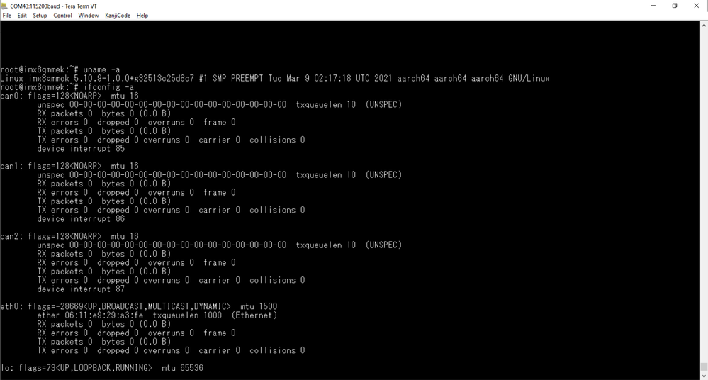

BiyongSUN
The  can driver is related to the kernel. not the rootfs of multi-media or full.
The can driver is enabled by default of the linux kernel.
Why the multi media wic image could not see the can interface on A core side.
Because the bootloader for the default wic image imx-image-multimedia-imx8qmmek.wic is with m4(bootloader imx-boot-imx8qmmek-sd.bin-flash_linux_m4), which assign the can to the m4 side hardware partition.
Please replace the bootloader with imx-boot-imx8qmmek-sd.bin-flash for the imx-image-multimedia-imx8qmmek.wic
Here is the test after replacing the imx-image-multimedia-imx8qmmek.wic bootloader with imx-boot-imx8qmmek-sd.bin-flash
Here is the uuu command or you can use the dd for the sdcard.
emmc: uuu -b emmc_all imx-boot-imx8qmmek-sd.bin-flash imx-image-multimedia-imx8qmmek.wic
binary release script uuu.auto already using the imx-boot-imx8qmmek-sd.bin-flash for emmc
sdcard:uuu -b  sd_all imx-boot-imx8qmmek-sd.bin-flash imx-image-multimedia-imx8qmmek.wic

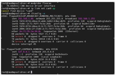

tony-atlismv
Yes, baseboard is connected, but is the file "imx8qm-mek.dtb" the default hardware file for the Yocto build imx-image-multimedia wic file? I ask this because even though modprobe shows the flexcan module, I'm unable to bring up a can node.
With modprobe:
root@imx8qmmek:~# modprobe flexcan
[ 18.700741] CAN device driver interface
But, if I do the following, I receive an error:
root@imx8qmmek:~# ip link set can0 up
Cannot find device "can0"
Is there a udev rule or script that I need to bring up the can0 to can2 devices with? Or, do I have to create an SD card image manually with a separate u-boot and rootfs partition?

carter_mcbride
So I believe the issue is that the prebuilt boot container in Yocto partitions the SoC in such a way that the M4 has control over the CAN subsystem.
Please try the following in Yocto:
 - add this line to the bottom of local.conf - IMXBOOT_TARGETS_imx8qmmek_append = " flash"
 - rebuild the image with bitbake imx-image-multimedia, or whatever image you were building previously
 - once the build completes, you should see "imx-boot-imx8qmmek-sd.bin-flash" in the images directory
Insert the SD card with your Linux image into your host machine, and run the following dd command to reprogram the boot container with this new image:
 - sudo dd if=<path to imx-boot-imx8qmmek-sd.bin-flash> of=/dev/sdX bs=1k seek=32 && sync, where sdX is the SD card device as enumerated on your machine
Once the above steps are completed you should be able to boot up into Linux with the default dtb, verify the flexcan module is loaded, and then run ifconfig -a to see the CAN interfaces.

It took me some time but I was able to make a full Yocto build for my iMX8MP SBC with the instructions provided for the local.conf file as suggested and for my target MPU. I do get the following prompt:
