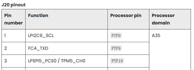

     I'm using iMX8ULP-evk to enable TPM in A core according to your article: https://community.nxp.com/t5/i-MX-Processors-Knowledge-Base/How-to-use-PWM-on-iMX93-EVK-board/ta-p/1...
    I chose PTF19 (J20 pin3) to generate PWM signal.
     After flashing, I open a terminal and execute the following commands:
cd /sys/class/pwm/pwmchip0;
echo 0 > export;
cd pwm0;
echo 400000 > period;
echo 200000 > duty_cycle;
echo 1 > enable;
    Then , I use oscilloscope to measure it waveform , and it keeps outputting a high-level signal.
    Could you give me some advice?

Hi @wendy-liu!
Try changing the driver from "fsl,imx7ulp-tpm" to "fsl,imx7ulp-pwm" in imx8ulp.dtsi.
tpm5: tpm@29340000 {
      compatible = "fsl,imx8ulp-tpm", "fsl,imx7ulp-pwm";
Additional you should disable the LPSPI5 since the LPSPI5 is using the pin PTF19.
Best Regards!]

Chavira
Hi @wendy-liu!
Best Regards!]

wendy-liu
Thanks! I have been solved!
