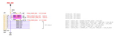

Hi @Chavira
I am using imx8ulp-9x9-evk and in A core I want to enable TPM for that I gone through below thread
https://community.nxp.com/t5/i-MX-Processors-Knowledge-Base/How-to-use-PWM-on-iMX93-EVK-board/ta-p/1...
In my board I am using PTF19(J20->pin3) pin for generate pwm signal
I put patch in attachemnt where I add tpm5 and pinctrl_tpm5 after that I given below command but I am not able to see any signal on pin.
$ cd /sys/class/pwm/pwmchip0/
$ echo 0 >> export
$ echo echo 1000000 >> pwm0/period  # Set period to 2,000,000 ns (2 ms)
$ echo echo 1000000 >> pwm0/duty_cycle  # Set duty cycle to 1,000,000 ns (1 ms)
$ echo 1 >> pwm0/enable

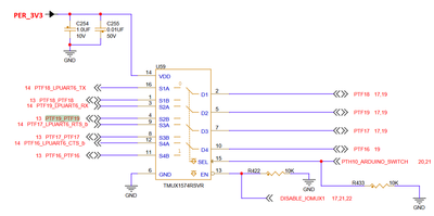

Chavira
Hi @dhruvinrajpura!
I tried and I noticed that LPSPI5 is using the PTF19 too.
By my side I disabled the LPSPI5 and I put in HIGH the signal TH10_ARDUINO_SWITCH with the command:
$ gpioset -c gpiochip2 10=1 &
Please check with dmesg command to see if you have a problem loading the proper driver because the pwm0 is not the tpm5 the pwm0 that you are watching is the tpm_rpchip_0.
For research purpose I use the PTF19 as a GPIO in Arduino Header without problem after that information you only have to add the tpm node in device tree.
Best Regards!

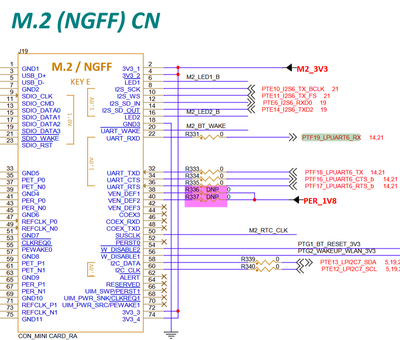

Chavira
HI @dhruvinrajpura!
Thank you for contacting NXP Support!
Your TPM configuration looks good, however the PTF19 is muxed externally.
To use that pin in the Arduino header you should add the next property to the TPM node:
pinctrl-assert-gpios = <&pca6416_1 10 GPIO_ACTIVE_HIGH>;
and additionally I recommend to disable the LPUART6.
in imx8ulp-evk.dts you should do the next change:
&lpuart6 {
	/* BT */
	pinctrl-names = "default", "sleep";
	pinctrl-0 = <&pinctrl_lpuart6>;
	pinctrl-1 = <&pinctrl_lpuart6>;
-       status = "okay";
+	status = "disabled";
	bluetooth {
		compatible = "nxp,88w8987-bt";
and delete the lpuart6 node in imx8ulp-9x9-evk.dts
&lpspi5 { /* conflict with lpuart6 PAD_PTF16-19 */
- &lpuart6 {
- 	pinctrl-assert-gpios = <&pca6416_1 10 GPIO_ACTIVE_LOW>;
after that additional changes you can see the output in the Arduino Header.
The PWM signal is on pin 22 of the M.2 connector with your current configuration.
Best Regards!
Chavira
