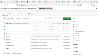

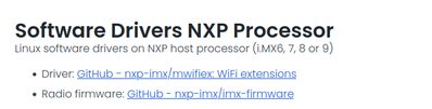

--Driver
#git clone https://github.com/nxp-imx/mwifiex.git
#cd mwifiex
#git tag
Then linux kernel version will be listed, you can select the version higher than yours.
For example, select the driver version for kernel lf-6.12.20_2.0.0
#git checkout lf-6.12.20_2.0.0
Then build it to get mlan.ko & moal.ko, and copy them to your board.
--Firmware & parameter file
Then download firmware & wifi_mod_para.conf
#https://github.com/nxp-imx/imx-firmware/tree/lf-6.12.20_2.0.0/nxp
then copy firmware & wifi_mod_para.conf to /lib/firmware/nxp folder of your board.

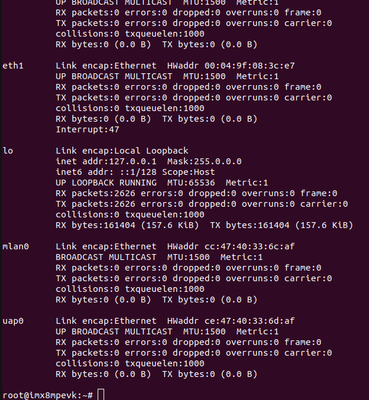

i.MX8MP-EVK DEMO image supports Wi-Fi driver, After you start i.MX8MP-EVK board,  you can run
the command to load wifi driver.
# modprobe moal mod_para=nxp/wifi_mod_para.conf
# ifconfig -a
So you don't need to build driver manually and loaded it.
Please share the logs after running above commands.
weidong

Yes, the i.MX8MP-EVK demo image supports the Wi-Fi driver. After starting the i.MX8MP-EVK board, I am able to load the Wi-Fi driver using:
# ifconfig -a
The Wi-Fi on my board is working fine — it can connect to networks and ping successfully.
However, when I try to use the Wi-Fi as a host access point (uap0), it does not work. Could you please clarify whether the AW-CM276NF Wi-Fi module on the i.MX8MP-EVK board supports host access point (uap0) mode?

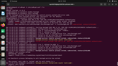

To enable host access point, I followed the steps in the document you shared:
88W8997-Software-Access-Point-Application-L5.4.70_2.3.0.pdf
When I run: systemctl start hostapd
I encounter the following error:
Could you please guide me on how to properly configure and enable host access point (uap0) on the i.MX8MP-EVK board?
niranjan
标记 (1)
1,288 次查看
weidong_sun
Hello @Niranjan123 ,
Sure, AP mode has been supported.
From your logs, your hostapd.conf file contains illegal characters, so hw_mode is not recognized. You need to ensure that your hostapd.conf is a plain text file.
Let me share mine with  you.

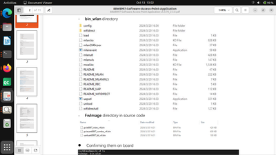

I have checked the Wi-Fi driver location mentioned on the NXP page:
https://community.nxp.com/t5/Wi-Fi-Bluetooth-802-15-4/Wi-Fi-Software-Drivers-Locations/ta-p/1940604?....
However, I’m unable to find the following directories in the source package:
  • bin_wlan
  • FwImage
Also, I couldn’t locate this specific driver package:
Generic_PCIE-WLAN-UART-BT-8997-LNX_6_1_55-IMX8-16.92.21.p84.4-16.92.21.p84.4-MM6X16423.P6-GPL
Because of this, I’m unable to proceed with the Wi-Fi Access Point (hostapd) configuration for the AzureWave AW-CM276NF (88W8997) module on the i.MX 8M Plus EVK.
Could you please help me with:
  1. The correct download link or package name for the Wi-Fi driver containing bin_wlan and FwImage.
  2. Steps or instructions to integrate it with the NXP Embedded Linux image (L5.4.70_2.3.0).
Thank you very much for your guidance and support.
