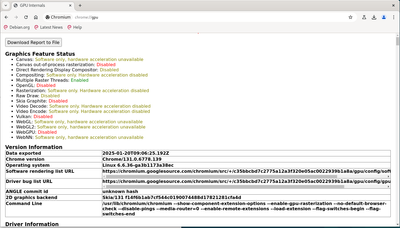

Hi Sirs,
After our test, the Debian Chromium (that is built by flexbuild) does not enable hardware acceleration, do we miss anything ?

Could you please send me a capture image of this directory in your browser (Chromium in board):
chrome://gpu
Also, you can try to run the WebGL Samples.

Hi Salas.
as below

You can try to enable Rasterization.
You can take a look to this community thread: https://community.nxp.com/t5/i-MX-Processors/iMX8MQ-webpage-UI-rendering-Graphics-performance-and/td...
There is explained how to enable it.
