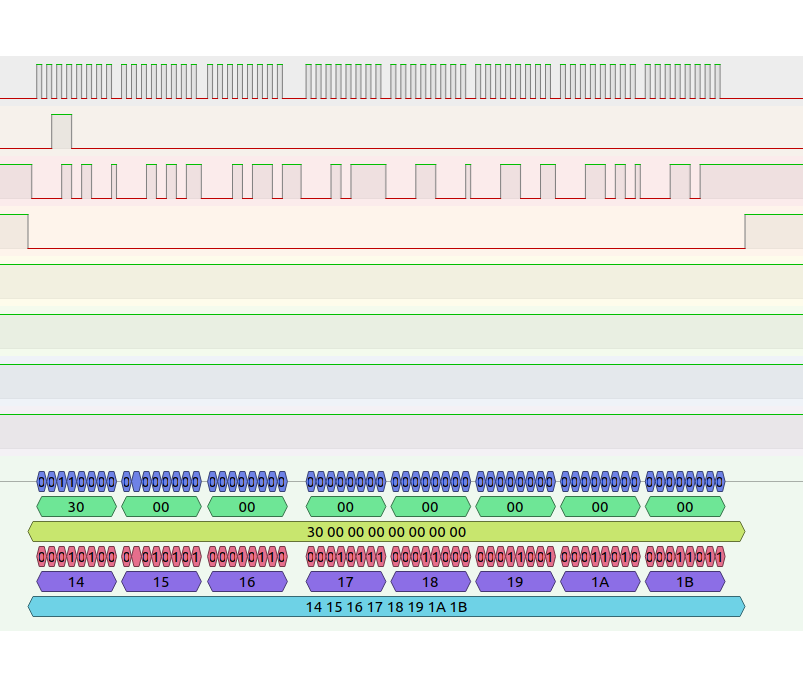

I am trying to enable SPI (spi2) in slave mode on imx6ul controller.
I am using a module from variscite - DART-6UL, Linux kernel 5.15.71 and yocto Kirkstone
The dtb changes are as follows
&ecspi2 {
cs-gpios = <&gpio4 22 0>;
pinctrl-names = "default";
pinctrl-0 = <&pinctrl_ecspi2_1>;
status = "okay";
#address-cells = <0>;
spi-slave;
slave@0 {
compatible = "var,spidev";
status = "okay";
&iomuxc {
pinctrl_ecspi2_1: ecspi2grp {
fsl,pins = <
MX6UL_PAD_CSI_DATA03__ECSPI2_MISO 0x100a0 /* from J13.2 */
MX6UL_PAD_CSI_DATA02__ECSPI2_MOSI 0x000a0 /* from J6.7 */
MX6UL_PAD_CSI_DATA00__ECSPI2_SCLK 0x000a0 /* from J11.9 */
MX6UL_PAD_CSI_DATA01__ECSPI2_SS0 0x070a0 /* from J6.5 */
The SPI_SLAVE is enabled, as shown
root@imx6ul-var-dart:~# zcat /proc/config.gz | grep SLAVE
CONFIG_I2C_SLAVE=y
# CONFIG_I2C_SLAVE_EEPROM is not set
# CONFIG_I2C_SLAVE_TESTUNIT is not set
CONFIG_SPI_SLAVE=y
# CONFIG_SPI_SLAVE_TIME is not set
# CONFIG_SPI_SLAVE_SYSTEM_CONTROL is not set
using the command spidev_test -v -D /dev/spidev1.0 -p 12345678
I wait for the master clock but the spi transmission is blocked for ever.

on the logic analyzer I see that the chip sends a 0x30 as shown below
