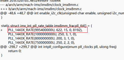

Please try below PLL settings.
/* Set Video PLL to 995.4Mhz for LVDS, p = 15, m = 622, k = 8192, s = 0 */
4,911 Views
leavs
Hi @Zhiming_Liu
I added the new PLL table, the result is same.
I checked the code detail and find that the clock_init() function in arch/arm/mach-imx/imx8m/clock_imx8mm.c is not run, and the function enable_display_clk() is also not run as I added some debug log in arch/arm/mach-imx/imx8m/clock_imx8mm.c.
I don't know why this clock_init() is not called in this BSP.
What do you think about this?

leavs
It works, I forget to put one picture/logo in the uboot.
