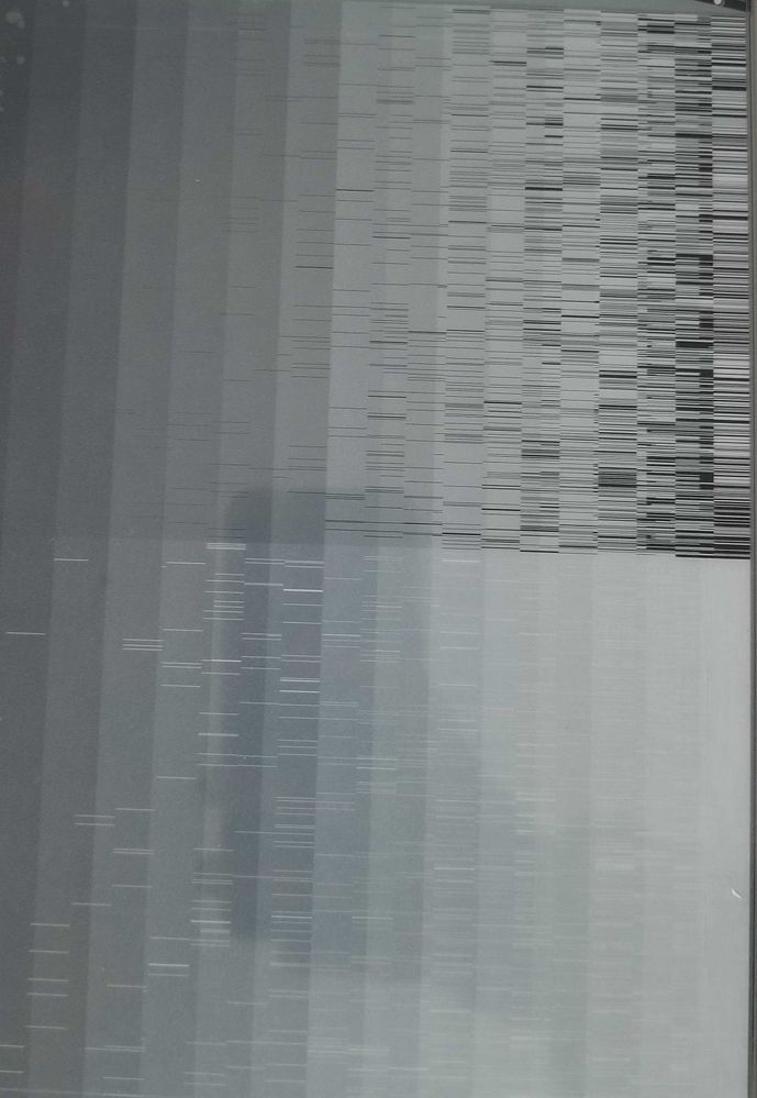

Greetings!
I am using 10.3" eink with imx7dsabresd board, I am facing the problem with unit tests which is default built,
I have attached the image with this question, kindly check it and suggest me what I am missing!
Thanks in advance!

igorpadykov
Hi Vikrant
for new epdc panel one can check suggestions in sect.10.3.3 EPDC Panel Configuration
sect.10.3.4 EPDC Waveform Loading attached Linux Manual.
igor

econote_vikrant
Hi Igor,
Thanks for your reply, but I have done those all steps already and I have the *.fw file converted from NXP only.
Is there any changes required as my panel's SDDO width is 16-bit.
I made changes into driver files accordingly but still I am getting those lines!

igorpadykov
Hi Vikrant
one can look at sect.10.3.4.1 "Using a Default Waveform File" Linux Manual,
so EPDC device driver was linked to correct *.fw file :
"using a nonpanel-specific waveform file for an E Ink panel results in more ghosting
artifacts and overall poorer color quality."
Test can use "default panel" ( first panel described in the video mode table)
in struct imx_epdc_fb_mode panel_modes[], change it to custom:
mxc_epdc_v2_fb.c\mxc\fbdev\video\drivers - linux-imx - i.MX Linux kernel
also check that kernel command line used necessary panel arguments.
Check images used for updating the display.  It may not be a correct size for the display.
The EPDC controller does not scale the image.
igor

econote_vikrant
Hi Igor,
I have done all the mentioned things in the previous answer, however, my waveform file is also correct, I received panel configurations and timing parameters converted from NXP only, I changed panel modes to custom also, if it wasn't correct I would have not seen those grayscale patterns also, so my only concern is why am I getting those lines as they are not related to ghosting, my panel's SDDO width is 16-bit so are there any other changes required in the driver file regarding any parameter?
I changed SSDO width in the driver file already

igorpadykov
Hi Vikrant
suggest to measure timings with oscilloscope and use eink datasheet to verify
that used correct waveforms and not default. Regarding SDDO width one can debug it
using jtag and driver description in Linux Manual.
igor

econote_vikrant
Hi Igor,
As per your suggestion, I have measured all the timings with oscilloscope against the Datasheet of the panel I am using. Everything is going according to the panel timings, but I am not figuring it out why these lines are getting displayed. I even checked vsync as well as num_ce values, tried to modify them but no change. Is there anything you suggest?

igorpadykov
Hi Vikrant
suggest to get additional help with more deeper analysis using
NXP Professional Services | NXP
