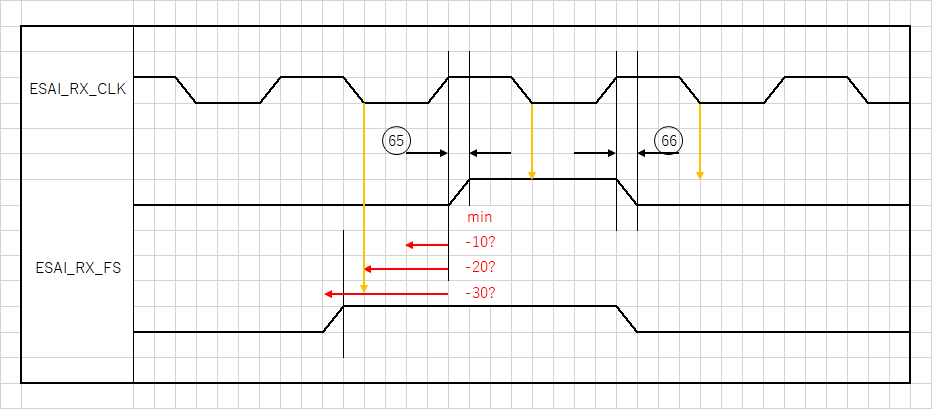

Hello community,
I hope know min value of ESAI timing on Table 49 of Datasheet IMX6DQAEC rev6.
ID 65, 66, 69 and 70 of Table 49, It have max value but no min value.
This parameters are defined by rise edge of ESAI_RX_CLK.
So slave device will be latched ESAI_RX_FS by falling edge of ESAI_RX_CLK.
If min value are smaller than 0, like -10, -20ns, it must care a latch timing of slave device.
Ishii.

Hi Ishii
>I hope know ..min value of ESAI timing ..ID 65, 66, 69 and 70 of Table 49..
for this case min value = 0

Hello Igor,
Thank you for your quick response.
I will ask it to my customer.
