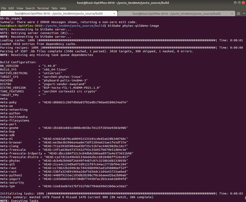

when I am creating image first time for imx8mm board via these command
$source sources/poky/oe-init-build-env
$bitbake phytec-qt5demo-image

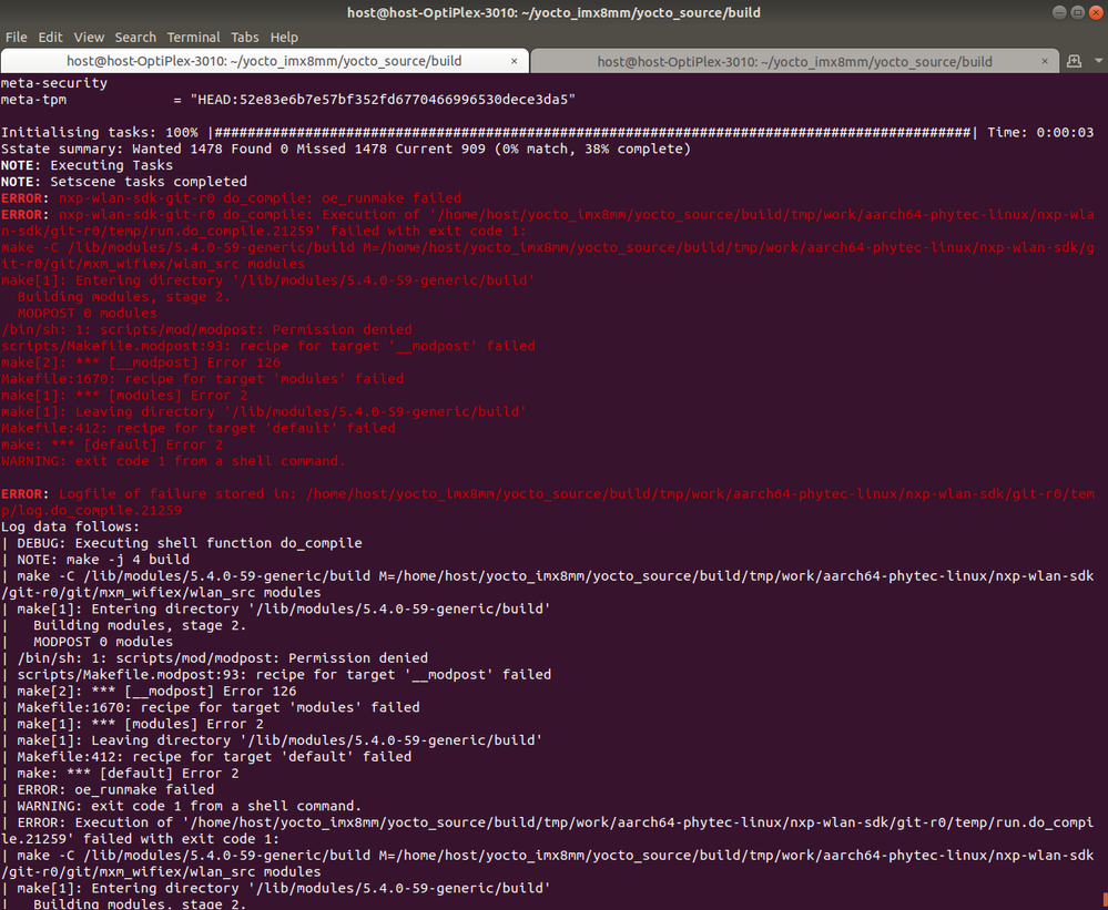

it is showing ERROR: nxp-wlan-sdk-git-r0 do_compile: oe_runmake failed , and
/bin/sh: 1: scripts/mod/modpost: Permision denied .
Screenshot from 2023-02-15 08-58-00.pngScreenshot from 2023-02-15 08-58-48.png

Hi @Gourav
The BSP you use is not maintained by NXP. The BSP we release doesn't have such issue.

hey
after changing ubuntu os version this problem solved
