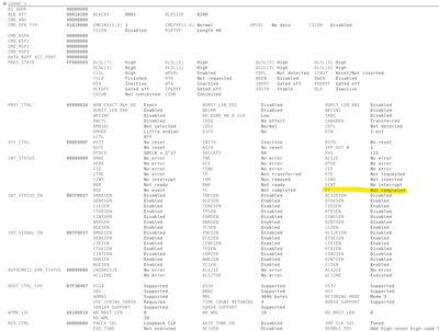

Dear expert,
I am using IMX 6Dual Lite processor (MCIMX6U8DVM10AB) and
EMMC 4.51 (MT29PZZZ8D5BKFTF-18 W.95L). The clock(400Khz) is fine from the
processor, but after issuing CMD1 the Present Status Register
(uSDHCx_PRES_STATE) of IMX6DL shows CIHB as 1 which means CMD line of eMMC is
busy and any further commands to the e-MMC will be ignored and it shows
"CMD1 Fail" .I believe, one of the reasons for no response from the
device is incompatible voltage range, but both emmc and the processor are set
to 3.3V.
Your inputs for this situation would be very helpful.

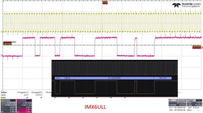

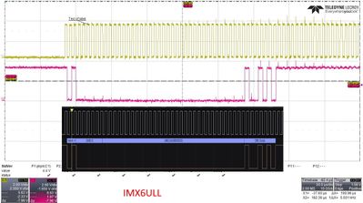

request:
response:

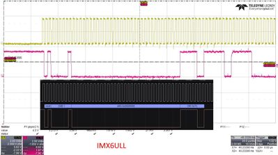

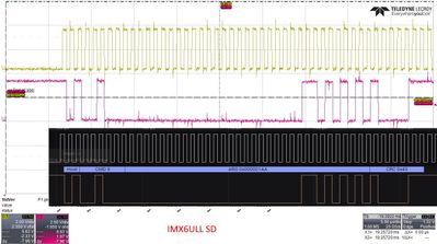

I can see the response on oscilloscope and logic analyzer, but MCU doesn't recognize it and keeps clocking the eMMC.
The CC bit in INT_STATUS register remains 1.

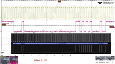

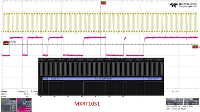

SD Card on USDHC1 works perfectly. By the way, waveform of CMD line of SD Card is a little bit better

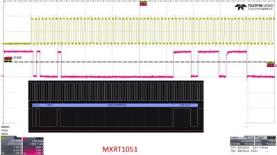

The same configuartion and eMMC chip i use in another custom board with MCU MXRT1051 and it MCU receives response properly.

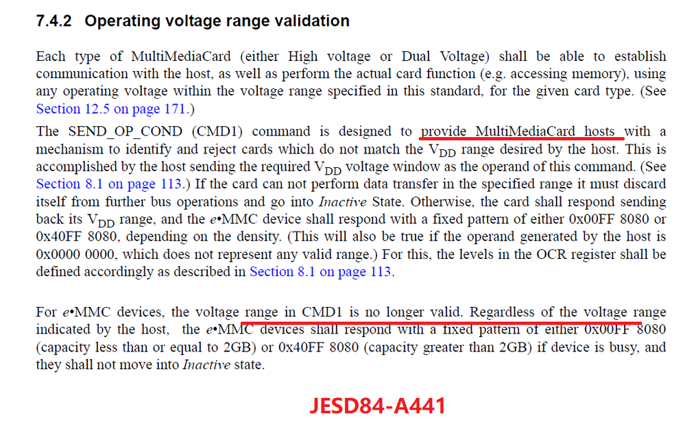

1. SD card follows SD Card Association  and emmc follows Jedec. You can see the  in the spec, it mentions it is different spec. Yes, it is similar. that why, linux driver share the sdhci.c as controller driver. and the chip uses the same controller as  silicon design.
2. It is sequence diagram in the spec. I just see some separate operations here.
3. I did n't see wave form compare to the spec and point out, it is wrong.
4. quote georgemakarov's test result, no wrong with the single command and response.

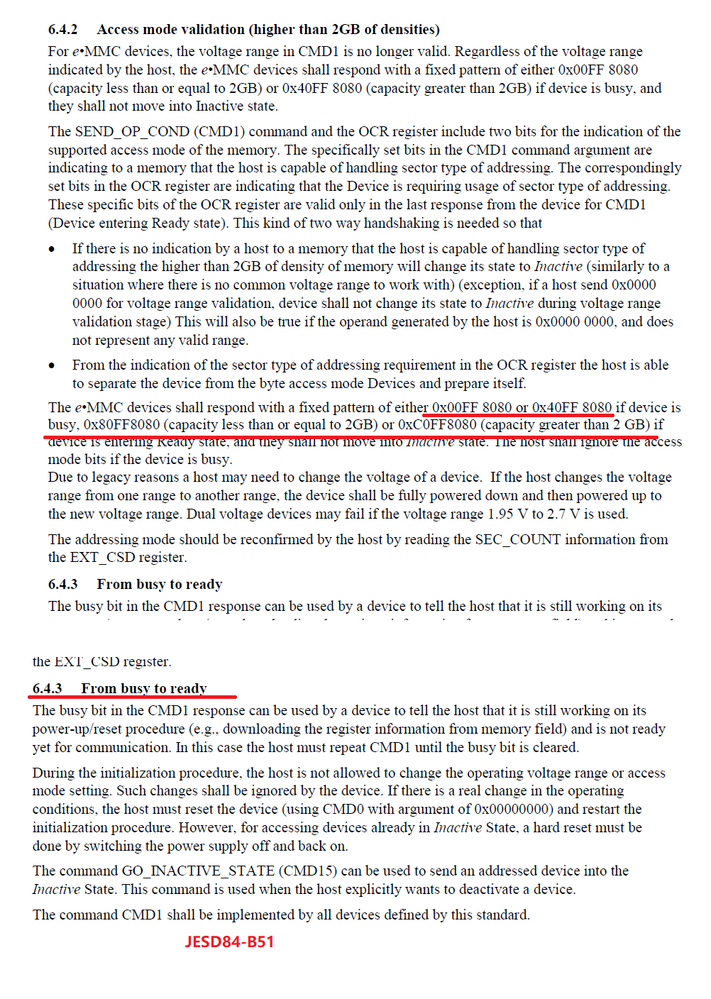

I  would further like to add that according to JEDEC eMMC standard, the device gives a response of 0X00FF8080 when the device is busy and hence should repeat the cmd1 till the device gets to ready state. I have repeated the cmd1 1000 times, but still at the end I get the result as CMD1 Fail.
From hardware perspective, I have checked all the possible cases regarding timing parameters , rise time, fall time of the signal. They all seem to be fine.
Please provide your valuable suggestions.

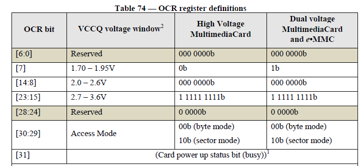

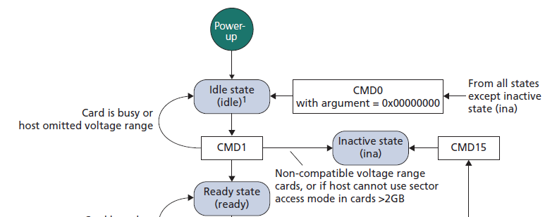

Thanks for the reply. I have checked eMMC connections, pull-ups(47K) on control lines(CMD),and have also referred to Sabre schematic. The schematics in our design seems to be fine. From the software perspective, i.MX6DL iomux control signals bits are set as per requirement. Still the CMD1 is failing.
Today when we analysed the waveform that we get on the command line (CMD1), it is observed that there is a proper response for the CMD1 (with argument 0xC0FF8080) from the card. From the waveform, we decoded the response as 0x00FF8080 (the 8080 bytes means the card is a dual voltage range one). As per the JEDEC
standards document it is understood that the card is responding back with  the power up status bit as busy(bit no. 31) and it is in byte access mode(bit no. 30 and 29).
As per emmc datasheet State diagram, this condition occurs when there is non-compatible voltage range card OR if host cannot use sector mode in cards >2GB.
Since we have checked the power levels of emmc and have got the response as 8080; I believe we can rule out
the non-compatibility voltage range and suspect the access mode as the issue here
Your suggestions for these would be very helpful.
