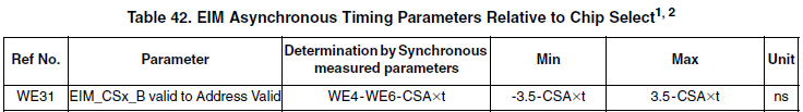

Hi Community,
We are developing custom board with i.MX6D. However, we can not clearly understand specification of EIM timing parameters.
From IMX6DQAEC REV.5
Linux BSP implementation:
  AXI_CLK_ROOT = 198MHz = PLL2 PFD2 396MHz / 2
  ACLK_EIM_SLOW_CLK_ROOT = 99MHz = AXI_CLK_ROOT / 2
Questions:
Q1.
The datasheet is described that "t means clock period from axi_clk frequency".
In above case, should we use AXI_CLK_ROOT(198MHz) for "clock period for t"?
I suppose we should use ACLK_EIM_SLOW_CLK_ROOT(99MHz) instead of AXI_CLK_ROOT(198MHz). Is it right?
Q2.

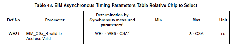

From IMX6SDLAEC REV.8
EIM timing definitions are different between i.MX6S/DL and i.MX6D/Q/DP/QP such as above figures.
I suppose i.MX6S and i.MX6D are using same EIM controller. but, why timing definitions are different as above?

Hi Kazuma
1.> I suppose we should use ACLK_EIM_SLOW_CLK_ROOT(99MHz) instead of AXI_CLK_ROOT(198MHz). Is it right?
right
2. >why timing definitions are different as above?
timings are the same, first makes more sense as according to
EIM EIM_CSnRCR1 definition CSA is EIM clock cycles, so "unit" is given
as combination "t"&CSA.
igor

I appreciate your support. Let me confirm regarding Q2.
<Conditions>
(1) CSA = 1 cycle
(2) ACLK_EIM_SLOW_CLK_ROOT = 99MHz = 10.1 ns time per cycle
(3) Timing definition
<Calculation>
In case of i.MX6D : WE31 MAX = 3.5 - CSA x t = 3.5 - 10.1 = -6.6ns
In case of i.MX6S : WE31 MAX = 3 - CSA = 3 - 10.1 = -7.1ns
<Question>
Is the above calculation correct? If correct, why timings are same in above case?
Kazuma Sasaki.

igorpadykov
Hi Kazuma
I think calculations are correct.
Where did you see that timings are same ?
igor

igorpadykov
Hi Kazuma
if you mean WE31, they are not the same.
igor
