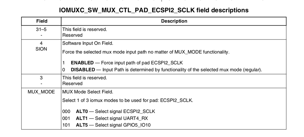

rutuja_patil
For 'MX8MM_IOMUXC_ECSPI2_SCLK_ECSPI2_SCLK 0x00001916', which register is configured ? As per my understanding Pad Control Register for the same has access upto 8th bit. But value configured is more than that.
5,070 Views
leexxa777
For 'MX8MM_IOMUXC_ECSPI2_SCLK_ECSPI2_SCLK', correct is 0x00000016 and it is a 32 bit register.
0x00001916 works, too, because there are reserved fields.
The screenshot from reference manual attached
