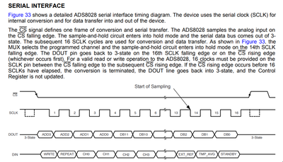

On the board with Cortex-M7, ADS8028 is connected via SPI. However, attempts to communicate with the ADS8028 device end in failure. I based my approach on the spi_polling example from the SDK. I configured the multiplexing correctly, according to the .dts file. But after sending a specific sequence of bits according to the ADS8028 datasheet via SPI, the RX buffer only records 0x0 or some garbage, now what I expect. Interestingly, the same behavior occurs even if the multiplexer is deliberately misconfigured or not configured at all.
What could be the problem?
