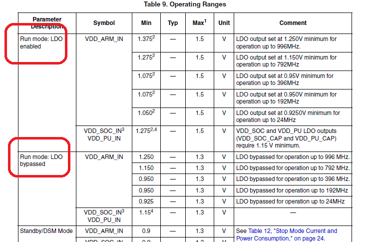

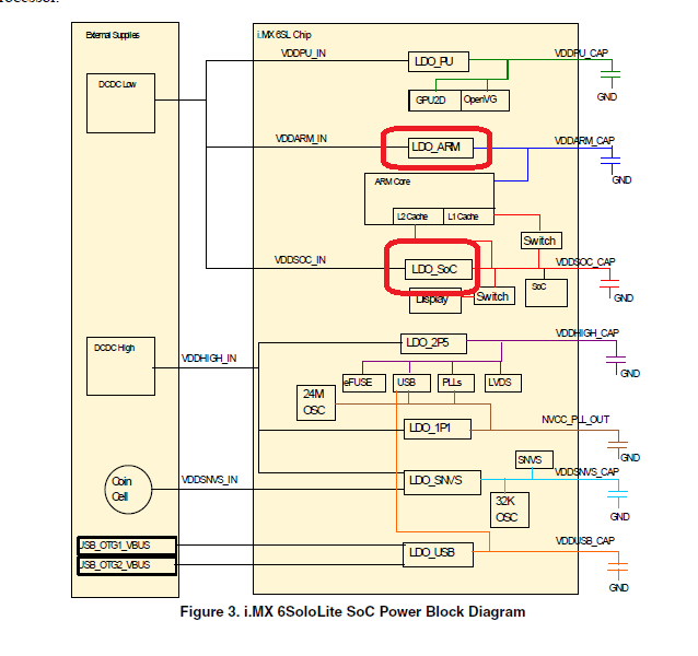

BiyongSUN
CMOS Sensor Interface (CSI)
It is for using the internal PMU LDO or not.
Please check the datasheet.
