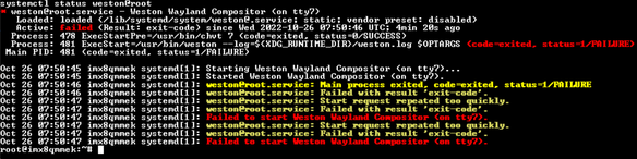

I am working on the i.MX8QM board and I desire to drive (display) LVDS panel on a DomU which is created with Xen hypervisor. Without Xen hypervisor, when I set the fdt_file as imx8qm-mek-jdi-wuxga-lvds1-panel.dtb on u-boot, the Weston service runs and I can get view on the LVDS panel. (imx8qm-mek-jdi-wuxga-lvds1-panel.dtsi is attached that I used, also screenshot of the status of the Weston when it is active.)
Then I reboot the board and, I run xenmmcboot to run with Xen hypervisor and Xen works properly. (I can see Domain-0 with xl list command as shown in the attached screenshot).
After that, I create DomU with the /etc/xen/domu-imx8qm-mek.cfg file which is also attached and I boot it with xl console DomU command. However, after booting, when I check the Weston service, I observed that it is failed so I cannot drive the LVDS panel from DomU. (imx8qm-mek-domu.dts is also attached.)

This problem is fixed and the display is working smoothly.
For some reason defining in the device tree the deserializer node and the display timing inside the serializer node were causing an issue. Also just providing the deserializer I2C address in the serializer node is sufficient.
So I removed the deserializer node and created a panel node to define the display timing like this:
