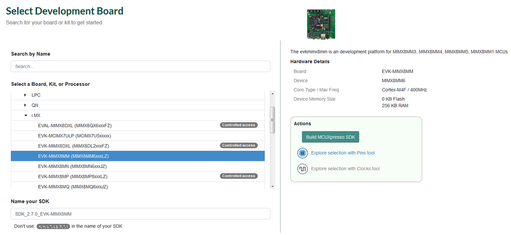

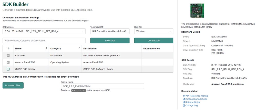

Download i.MX8MM-EVK SDK from the link, then try to run SDK example code on M4 core.
https://mcuxpresso.nxp.com/en/select
Press Build MCUXpresso SDK button:

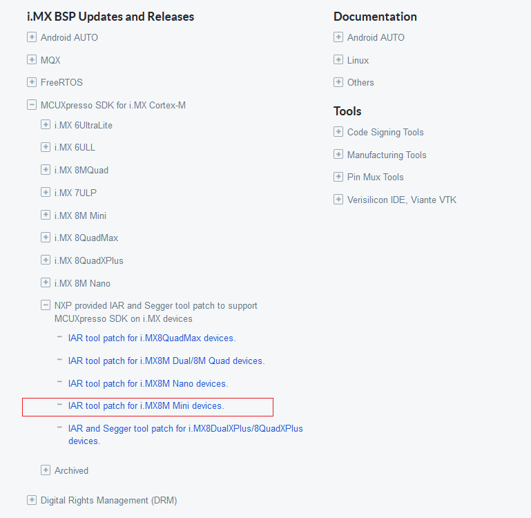

Before using IAR to connect i.MX8MM, you should do these steps:
1. IAR tool patch for i.MX8MM
i.MX Software | NXP
download it, and decompress it, you can find a arm directory, copy the directory to IAR intallation directory , recover original arm, for example , my installation directory is : D:\Program Files (x86)\IAR Systems
2. Download latest segger driver from segger website, up to now, it should be v6.80. then setup it to your PC.
3. Loading hello world project to IAR, don't forget to select "target" in "options-->targe".
Then try it again.

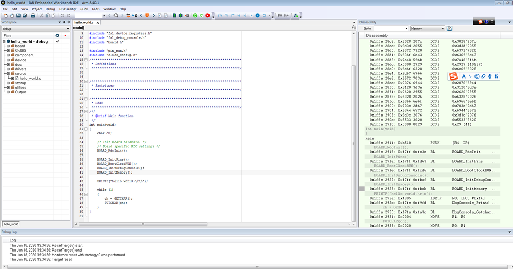

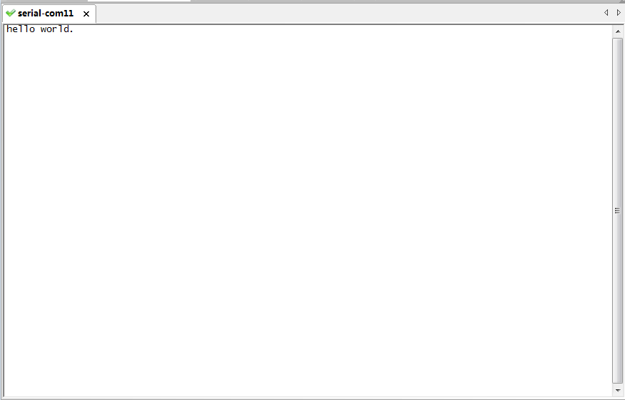

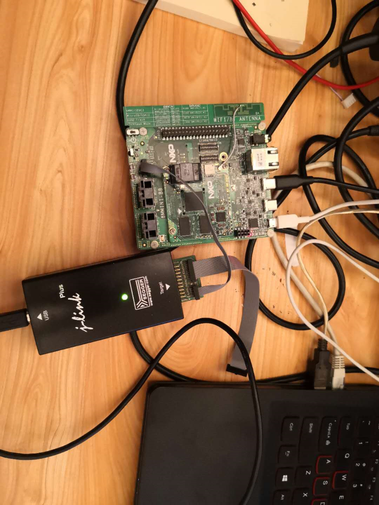

weidong_sun
Hi Thorsten,
Below is my environment and steps:
1. IAR 8.40.1
2. debugger: Jlink Plus.
firmware should be latest one.
3. SDK_2.7_imx8mm
4. example code: Hello world
6. See my test result.
[Comment]
Don't need to set BOOT_MODE to be serial download mode.
Hope above is helpful to you.
