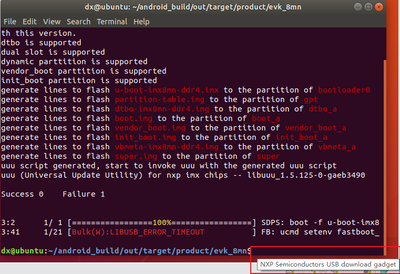

My development environment is VMware+Ubuntu 18.04, and I am using uuu tools for i.MX 8M Nano Evaluation Kit | NXP Semiconductors but download image fail, it looks like a USB switching problem, see the attachment for the detailed process. download successfully in the Windows environment
Is there any solution to the problem of using uuu tools in a VMeval environment?

Hi @ethan_dang1
The guide in uuu.pdf (Release 1.5.21 · nxp-imx/mfgtools · GitHub) about "How to use uuu in virtual machine" might help you.

ethan_dang1
Hi @Harvey021
The problem has been solved, thanks!

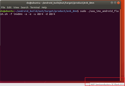

ethan_dang1
Hi @Harvey021 ,
I've done that.
Map HID device into virtual machine
Map fastboot device into virtual machine after uboot boot
