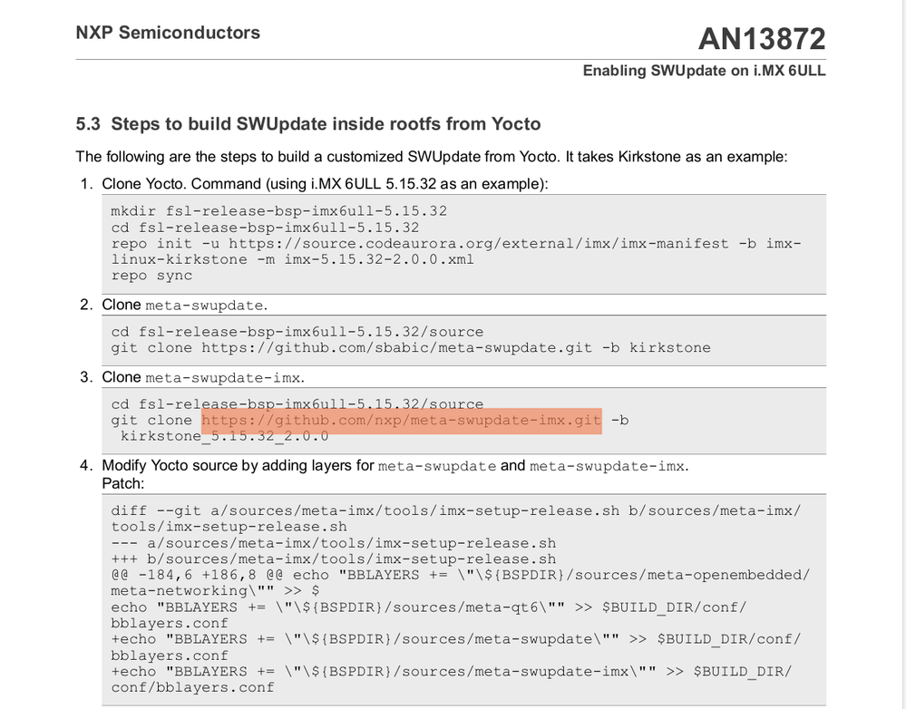

Dear Community, CC: @Chavira
I followed the discussion on swupdate-scripts in this forum to download the AN13872 Enabling SWUpdate on i.MX 6ULL document. In this document, another swupdate-related repository is mentioned :
However, it seems that the meta-swupdate-imx repository does not exist. I would like to know how to access it, please ?
Thanks in advance and best regards,
Khang

Hi @khang_letruong!
Thank you for contacting NXP Support!
Sorry for the mistake, the repo has changed the link.
The correct link of this repo is the next:
https://github.com/nxp-imx-support/meta-swupdate-imx
Best Regards!
