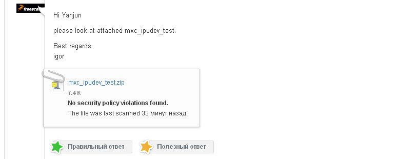

igorpadykov
Hi Yanjun
please look at attached mxc_ipudev_test.
igor
3,617 次查看
YanjunLuo
Hi igor,
Many thanks for your support, where can I find the attached file? I'm familiar with the forum usage.
Yanjun Luo.
3,617 次查看
igorpadykov
do you see picture ? Clock on "mxc_ipudev_test.zip"
on my answer above in previous thread.
3,617 次查看
YanjunLuo
Hi igor,
Many thanks for your kindly support!, I got the file, I'll test it.
Yanjun Luo.
