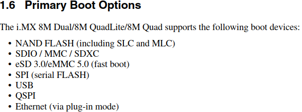

In i.MX8M reference manual revision 1.
1.6 says support boot from NAND, SDIO/MMC/SDXC, eMMC, SPI, USB, QSPI and Ethernet.
6.1 says support boot from SD/MMC and NAND flash.
Which one is right?

Hello m.c.
Both are rigth the i.MX8M can boot from NAND, SDIO/MMC/SDXC, eMMC, SPI, USB, QSPI and Ethernet, but the boot ROM suport NAND and SD/MMC, The boot ROM uses the state of the BOOT_MODE and eFUSEs to determine the boot
device. For development purposes, the eFUSEs used to determine the boot device may be overridden using the GPIO pin inputs.

Hi Bio_TICFSL,
i don't get it.
This thread (https://community.nxp.com/thread/473293) is saying that there is no boot options from QSPI.
So how do i implement booting from QSPI after your statement.
Thanks in advance!
