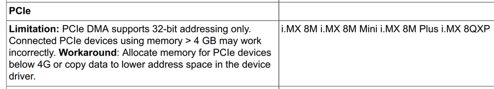

Hello experts,
I am evaluating Windows 10 IoT Enterprise on i.MX8M Plus EVK, using W21H2-1-5-0-imx-windows-bsp.
I used an adapter module to convert the M.2 KEY-E on the i.MX8M Plus EVK to M.2 KEY-M. After installing the PCIe NVME SSD, Windows cannot boot normally.
Restrictions on PCIe in i.MX Windows 10 IoT Release Notes Rev. 1.5.0:
I don't understand this very clearly. Can it be considered that even if NVME SSD is supported, the capacity of the SSD cannot exceed 4GB?
338 Views
JorgeCas
NVME SSD is supported but not working properly, yet. Issue has been reported to Microsoft but solution still on-going.
