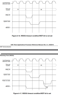

Hi, all.
I want to know whether boot ROM run or not when watchdog reset asserted.
My customer's product sometimes not wake up from Low Power mode.
I want to find it comes from errata e10574 or not.
Thanks.

T-Ii
Customer doesn't use BSP based OS but proprietary RTOS.
Which point does BPS version affect to watchdog reset?

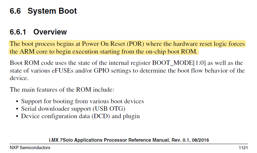

Rita_Wang
ROM code will start immediately after POR_B deactivated.

T-Ii
Thank you for replying.
Let me confirm my understand.
A. boot ROM does not run when watchdog asserted without WDT bit set. (see Figure 6-16. below)
B. boot ROM run when watchdog asserted with WDT bit set. (see Figure 6.17. below)
C. errata e10574 happens in either case.
Is my understanding right?
1,647 Views
Rita_Wang
Yes
