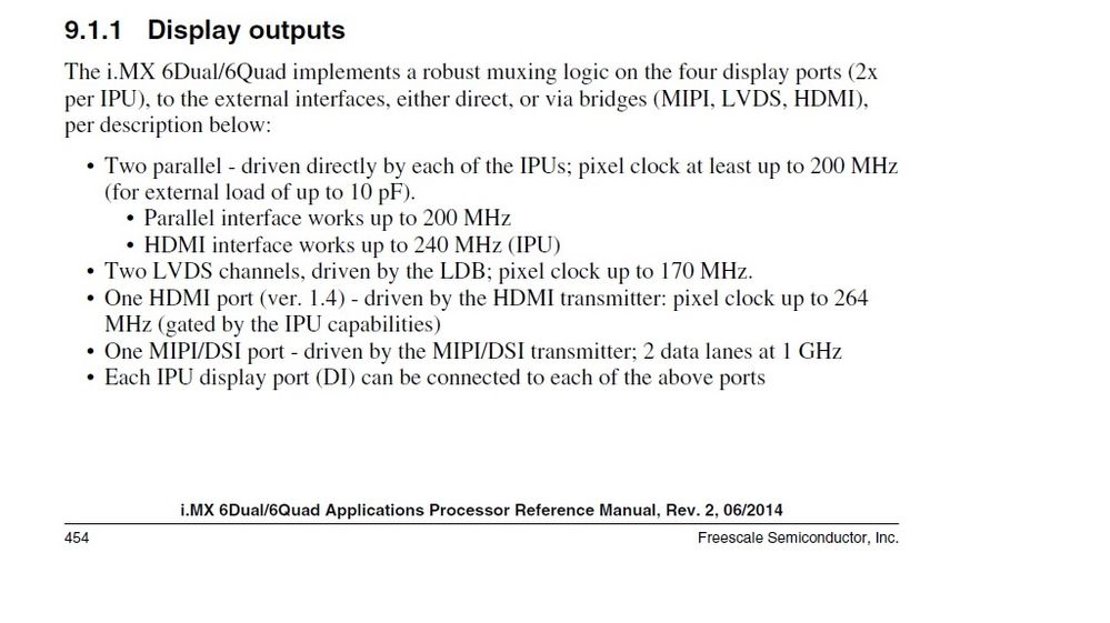

We want to connect i.mx6 to a 2048x1536 eDP LCD panel(pixel clock is 205MHz), since i.mx6 doesn't support eDP we will use a convert IC.
From the i.mx6 user manual,
RGB interface is 225Mpixel/s(datasheet say it is 225M, but user manual say it is 200M, which is correct???), maybe OK.
MIPI interface is 1280x720p at most, so this interface is not acceptable.
Dual lane LVDS is 170Mpixel/s at most, so it is not acceptable too.
HDMI interface is 270MHz.
It seems HDMI interface can support 2048x1536 resolution, and maybe RGB interface can support too.
Which interface should we use? Does anybody succeed to using a 2048x1536 panel in i.mx6 panel? Does i.mx6 dual lite and i.mx6 quad both support?

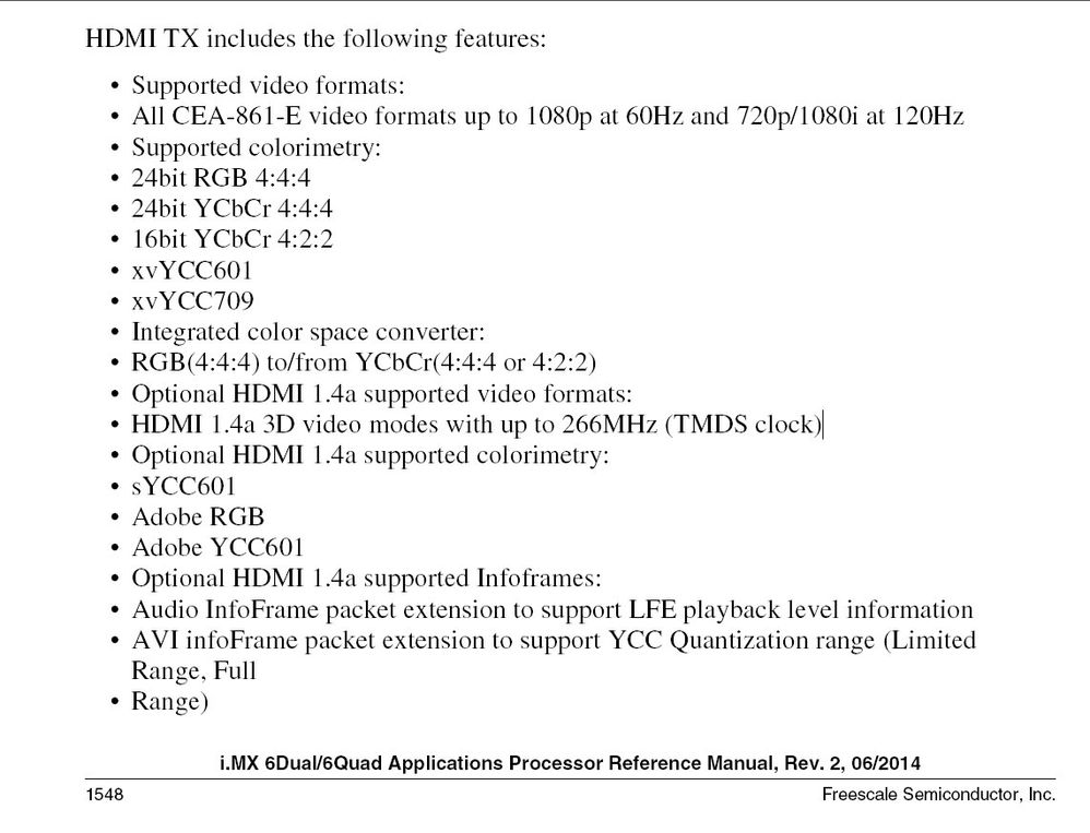

igorpadykov
Hi lonsn
IPU RGB interface supports such resolution, HDMI not (IMX6DQRM  p.1548).

lonsn
Thanks igorpadykov's reply!
Can you help to double confirm the HDMI resolution support? Because from the doc https://community.freescale.com/docs/DOC-104336
In P16/P18, it says the HDMI can support QXGA(2048x1536).
And in this thread: https://community.freescale.com/docs/DOC-100706, this board also claims to support HDMI QXGA resolution.
For RGB interface, what's the max pixel clock frequency?

igorpadykov
Hi lonsn
please use official (located on web product page) documents, such as
Datasheet, Reference Manual as most confident source
of technical information. These documents are thoroughly
reviewed by FSL doc team and updated or regular basis.
Also on web you can find experimental and not fully verified solutions,
which can be used with care.

lonsn
OK, Understand maybe the HDMI interface for higher resolution than 1080p is still experimental.
We will test the parallel RGB interface. I want to double check the max parallel pix clock. In datasheet P6, it says up to 225M, In user manual P454, it says up to 200M. Please clarify which one is correct. Since our panel needs 205MHz pixel clock for 2048x1536, it is critical for us.

igorpadykov
it is 240MHz, as shows attached part of RM
