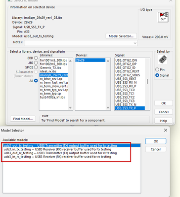

in the USB3 TX IBIS-AMI model, there are e.g. 4 models selectable in the model selector, see screenshot.
What is the exact meaning of these 4 models and the background of that?

I suggest you use usb3_out_tx_testing.
There is no documentation related to the other models since were used for internal testing and this is a dedicated out in the IOMUX documentation.
