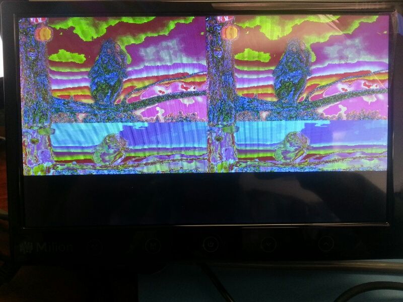

I am having problems with distorted video.  I have done quite a bit of testing.
Attached is a picture of the issue (toward bottom)
My gStreamer pipelines must be correct because other resolutions work fine.
The problem only occurs when you play a video that has the same resolution as the display.
Display is HDMI.
For instance, a 1920x1080p video played on a 1280x720p video plays perfect.  A 1280x720p video played on a 1920x1080p video plays perfect.
But a 1280x720p video played on a 1280x720p Display plays distorted. Also a 1920x1080p video played on a 1920x1080p display plays distorted.
I have tested Yocto 1.5 (3.10.17) and Yocto 1.3 (kernel 3.0.35)
Below is some snippets of information from my system that may help.
I am using the Big Buck Bunny Video for testing as well as video test source (free download HERE)
I am not sure if the issue is in the driver or the gstreamer plugin?

gst-launch videotestsrc ! video/x-raw-yuv,width=1280,height=720 ! mfw_v4lsink device=/dev/video16

It seems there is some issue in clk_round_rate(), I haven't found the root cause, but I think you can use the followed workaround to get the 27MHz BT656 pixel clock:
In file ipu_disp.c, function ipu_init_sync_panel():
   rounded_pixel_clk =
    clk_round_rate(ipu->di_clk[disp], pixel_clk);
+   if(pixel_fmt == IPU_PIX_FMT_BT656)
+    rounded_pixel_clk = 108000000;
   ret = clk_set_rate(ipu->di_clk[disp],
      rounded_pixel_clk);

I was not able to reproduce the issue with 1080p HDMI resolution + 1080p resolution movie.

Or with 1280x720
With both movies I can see it clear in my HDMI.
Can you, please, help me to reproduce it?

I tested again with the same movies I had test before. And I was not able to reproduce the issue.
What is the board you are using? I only have access today to one imx6dlsabresd, but I can test imx6dlsabreauto next week.
Can you, please, try to reproduce using a Freescale Reference Board?

The exact command line you shared works fine over here.

Linux ventana 3.10.17-1.0.0_ga+yocto+g44f5a1b #1 SMP Mon Jun 23 13:53:13 PDT 2014 armv7l GNU/Linux
root@ventana:~# cat /proc/cmdline
# no video= params to override the deafult mxcfb configuration from devicetree which is HDMI, CVBS, LVDS for our board
console=ttymxc1,115200 root=ubi0:rootfs ubi.mtd=2 rootfstype=ubifs debug
root@ventana:~# dmesg | grep mxc_sdc_fb
[    0.650594] mxc_sdc_fb fb.31: registered mxc display driver hdmi IPU1_DISP1
[    0.685380] mxc_sdc_fb fb.32: registered mxc display driver adv739x IPU2_DISP0
[    0.695182] mxc_sdc_fb fb.33: registered mxc display driver ldb IPU1_DISP0

# default display output is 1080p
# attempt 480p input source to 1080p output (this shows fine)
gst-launch videotestsrc ! video/x-raw-yuv,width=720,height=480 ! mfw_v4lsink device=/dev/video16 sync=false

# attempt a 1080p input to a 1080p output (this shows display issues)
root@ventana:~# gst-launch videotestsrc ! video/x-raw-yuv,width=1920,height=1080 ! mfw_v4lsink device=/dev/video16 sync=false

# change the default 1080p output to 480p
root@ventana:~# echo "S:720x480p-60" > /sys/class/graphics/fb0/mode
root@ventana:~# cat /sys/class/graphics/fb0/mode
S:720x480p-60
root@ventana:~# fbset
mode "720x480-60"
    # D: 27.000 MHz, H: 31.469 kHz, V: 59.940 Hz
    geometry 720 480 720 480 12
    timings 37037 60 16 30 9 62 6
    nonstd 842094158
    rgba 8/16,8/8,8/0,0/0
endmode
# now we are at 480p output
# 480p source to a 480p output shows display issues
root@ventana:~# gst-launch videotestsrc ! video/x-raw-yuv,width=720,height=480 ! mfw_v4lsink device=/dev/video16 sync=false

The above seems to indicate to me that whenever scaling is necessary the output is fine, but whenever the input resolution matches the output we have problems.
With the following patch, this issue appears to be resolved, but I'm not clear if its a valid fix or if it will cause other issues:
diff --git a/drivers/media/platform/mxc/output/mxc_vout.c b/drivers/media/platfo
index 9cb4568..89326d9 100644
--- a/drivers/media/platform/mxc/output/mxc_vout.c
+++ b/drivers/media/platform/mxc/output/mxc_vout.c
@@ -1219,6 +1219,7 @@ static int mxc_vout_try_task(struct mxc_vout_output *vout)
        /* assume task.output already set by S_CROP */
        vout->linear_bypass_pp = is_pp_bypass(vout);
+vout->linear_bypass_pp = 0;
        if (vout->linear_bypass_pp) {
                v4l2_info(vout->vfd->v4l2_dev, "Bypass IC.\n");
                output->format = input->format;
Are you saying that you cannot recreate the issue above using a SabreSD with 3.10.17_1.0.0-ga kernel, yocto1.6 userspace, and default kernel cmdline such that HDMI is fb0?

We are using the Freescale patches to support BT656/BT1120 in order to support analog video output from here: Patch to Support BT656 and BT1120 Output For i.MX6 BSP
It is something in this patch that is causing the issue - if I revert that patch the issue goes away.
Is there a reason why Freescale is not supporting the patches at Patch to Support BT656 and BT1120 Output For i.MX6 BSP in their BSP? From the community posts here I see that several customers are using that and thus going through the trouble of porting and possibly debugging the patch every kernel version.

qiang_li-mpu_se
Hi Tim, after applied the BT656 output patch, you should pay attention to the frame buffer format, for BT656, the video data output from display interface should be the UYVY format, so when it is the second display on iMX6S/DL, the frame buffer will be UYVY format too.
In v4l2 output driver, the patch had added code to identify the DIFMT and FBFMT, that was used to fix the video playback color space issue.
There are also many discussions in the original patch link for this limitation.

I'm not using BT656 in this example. I'm not sure where the issue is yet, but the BT656 output patch applied to the 3.10.17 kernel is causing issues when the CC is bypassed. My current work-around is to always force the CC to not be bypassed.  Please see https://community.freescale.com/message/417495#416126 above. If I'm misunderstanding please point me to the specific portion of the patch that is supposed to deal with this.
I'm suspecting that your updated BT656 output patch on 2013-08-09 which includes '0003-Enhance-dual-display-support-for-BT656-output.patch' also resolves another issue I'm currently having with regards to dual display CVBS+HDMI.
As 3.10.17_1.0.0_ga is a 'ga' kernel, can you please port your patches to this kernel? Its obvious that several Freescale customers are depending on those patches.
Tim

qiang_li-mpu_se
Hi Tim, I had released the patch "L3.10.17_1.0.0_GA_bt656_output_patch_2014-07-21.zip" at https://community.freescale.com/docs/DOC-94019
The video playback issue with IC bypass had been fixed in it.
12,161 Views
timharvey
Contributor V
I'm testing it now along with the adv7393 patch of yours that I ported to 3.10.17 (link above).
This patch does seem to resolve the IC bypass issue as well as a similar issue I encountered with mfw_isink.
