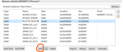

jingpan
Hi @Devaharsha ,
Obviously, OCRAM has not enough size for the buffer. You should split part of SDRAM to NCACHE_REGION.
Jing
5,042 Views
Devaharsha
Can you give an exact value of how much can be provided and exactly how to split RAM sizes in MCU IDE?
5,036 Views
jingpan
Hi @Devaharsha ,
Goto properties->MCU Settings
5,026 Views
