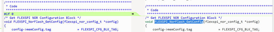

At this point, methods like ROM_FLEXSPI_NorFlash_GetConfig() are not present in ROM API implementation for 1050, and if I also brutally replace fsl_romapi.c/.h files from "evkbimxrt1060_fsl_romapi" example then I fall into Hard Fault runtime exception due to ROM API code incompatibility:
just do the FLEXSPI_NorFlash_GetConfig modification with the QSPI flash
Could you please better explain what do you mean I have to do when you say that?

kerryzhou
Hi @SpoonMan ,
  Yes, RT1050, RT1060 ROM API is not the same.
  As the RT1060 ROM support the get_config, but RT1050 can't support it.
You need to manually configure the get_config in the RT1050, just this API:
void FLEXSPI_NorFlash_GetConfig(flexspi_nor_config_t *config)
I mean, you need to modify the API internal related configuration, the config-> LUT, etc.

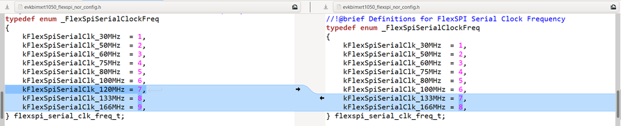

In the following, I'll report what I modified in 1050 ROM API example project to make it working with QSPI Flash, instead of HyperFlash. In all the screenshots I'm going to post, left side is always MODIFIED code, right side is ORIGINAL EXAMPLE code.
First, I adjusted BOARD_FLASH_SIZE macro in board.h to reflect QSPI Flash total size:
Then I basically replaced evkbimxrt1050_flexspi_nor_config.h and evkbimxrt1050_flexspi_nor_config.c content with code from evkbimxrt1060_fsl_romapi example project; in evkbimxrt1050_flexspi_nor_config.h file, the only difference is the following:
while for evkbimxrt1050_flexspi_nor_config.c file basically EVERYTHING is different; in this case, let me just copy-paste modified file content:

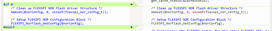

I commented out everything related to local norConfig copy in main() method:

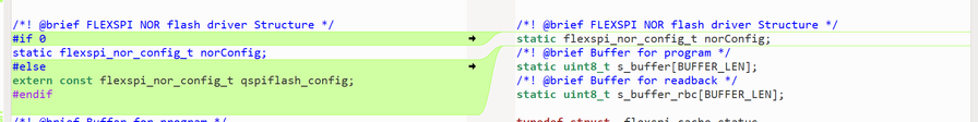

then, in each call involving norConfig pointer, I substituted it with (flexspi_nor_config_t*)&qspiflash_config. Let me post just some examples and not the entire code, you can do it by yourself easily:

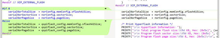

Also local variables used for total FLASH size calculation etc. should take memory geometry information from qspiflash_config instead of norConfig:
and, more than this, qspiflash_config should be visible from main source file:
