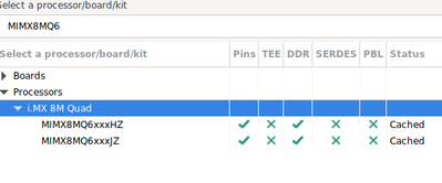

I would like to configure the pins of my i.MX using the Config Tool software.
I read on the component that I have the reference MIMX8MQ6CVAHZAB, which I found in the documentation (see screenshot).
But when I search for it in the software Config Tool, the most similar reference is MIMX8MQ6xxxHZ or JZ, so can I configure that it is the same reference, or are there differences? (and in this case, how to find MY component).
Thanks in advance.

MIMX8MQ6CVAHZAB corresponds to MIMX8MQ6xxxHZ (there is no difference).
Please take a look on the next image for reference:
