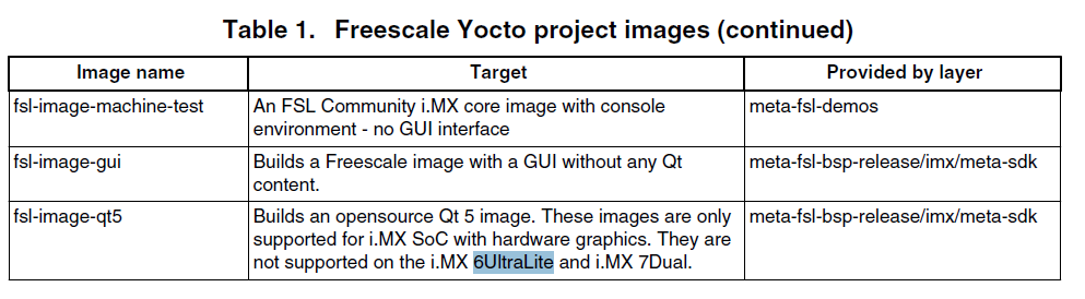

I used to porting linux by using Yocto Project on i.MX6 Dual core.
Nowadays, my boss told me to evaluate how to porting linux by using Yocto Project on i.MX6 UltraLite.
After I read the document "Freescale_Yocto_Project_Usere_s_Guide" and I saw this Chapter as below.
Is that mean fsl-image-qt5 is not support on i.MX 6UltraLite but the others can?
Or the Yocto Project did not support for i.MX6 UltraLite?
Thanks in Advanced!

mx6ul doesn't have GPU, but now we don't support qt for non-gpu, but we have qt build for mx6ul, which hasn't tested,
for more detailed information, pls refer to the link as below:
https://community.nxp.com/docs/DOC-333580
