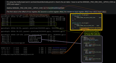

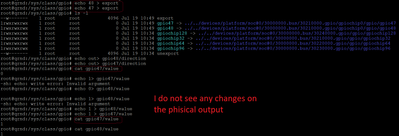

Hi all. I can not get work gpio.
In my case this is not working, I do not see any change on the physical GPIO pin
echo 47 > /sys/class/gpio/export
echo out > /sys/class/gpio/gpio47/direction
echo 1 > /sys/class/gpio/gpio47/value
Some additional details below. What can be wrong?

The pictures are a bit of a mess to follow. Try reading this application note and see if it helps:
https://www.nxp.com/docs/en/application-note/AN5078.pdf

I found problem, The Controll Mux register for specific pins had incorrect values.
The pins was set for peripheral purpose instead of gpio purpose (MUX_MODE)
