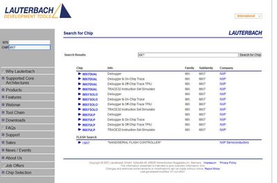

igorpadykov
Hi David
one can try lauterbach tools available on linux
https://www.lauterbach.com/frames.html?home.html
igor
