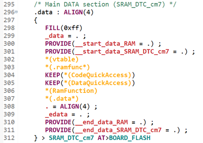

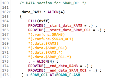

Hello Team,
I have a few queries regarding the usage of ".ramfunc" in the .data Sections of the Linker Script and the default usage of DTCM for storing data:
1. What is the specific use of "*(.ramfunc.$RAM3)"? What are the configuration changes occurring due to inclusion of these Input Sections?
2. Is it really necessary to define "*(.ramfunc.$RAMx)" in all the RAM_x Segments?
3. As per the Memory Map file generated, no other Section other than BOARD_FLASH and DTCM are being used for the application execution. Is it a default to use DTCM among all the other RAM segments available?
4. How can I change the default RAM segment in the Linker Script being used for my application?
5. Where are the "CodeQuickAccess", "DataQuickAccess" and "RamFunction" Sections defined in the Input files?
Prabhat Kiran.
