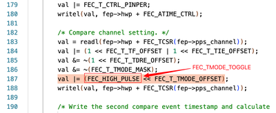

For drivers/net/ethernet/freescale/fec_ptp.c, need to use FEC_TMODE_TOGGLE for capturing signal with normal oscilloscope.
