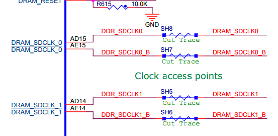

about imx6 DDR3 design,there is no need to connect DRAM_SDCLK_0 and DRAM_SDCLK_1 with CK of DDR3?
iMX6 SabreSD board do not use  DRAM_SDCLK_0 and DRAM_SDCLK_1 ,but some other board use them ,i want to know what is the effect of DRAM_SDCLK_0 and DRAM_SDCLK_1? thanks

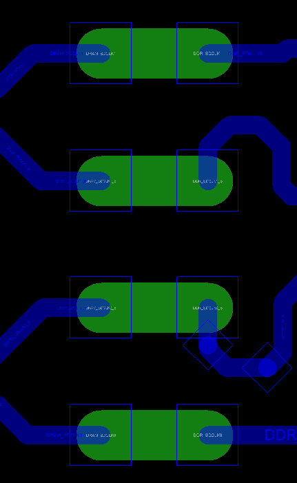

Hello Dq,
these pads serve as clock access points. By default the 0R resistors are not mounted and their pads are bridged by
scratching planes.

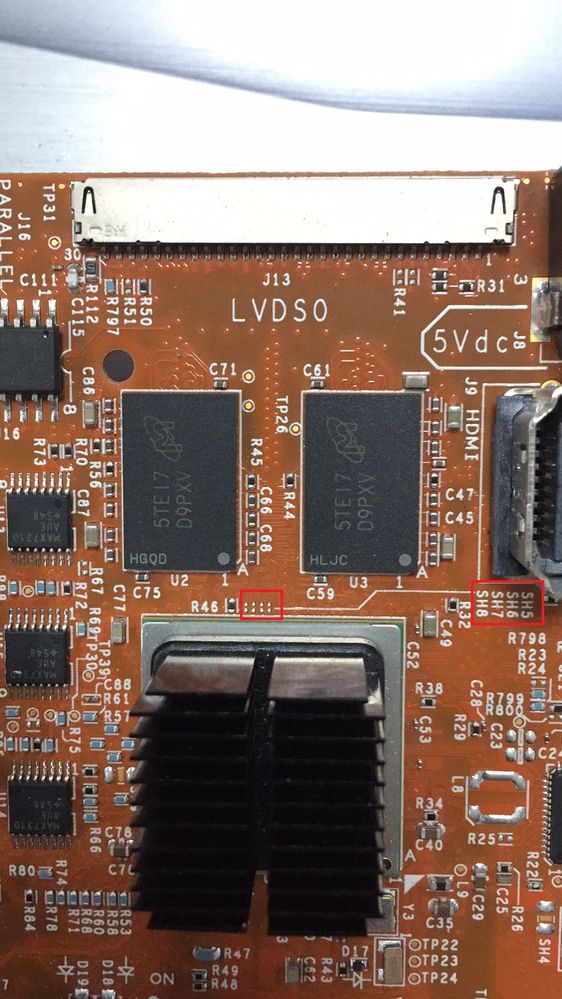

Helo Dq,
clock always has to be provided to the DDR3 device. i.MX6 SabreSD uses DRAM_SDCLK_0 and DRAM_SDCLK_1. Could you please share the schematic from which you determined that those clocks are not used?

Hello Dq,
scratching planes.
