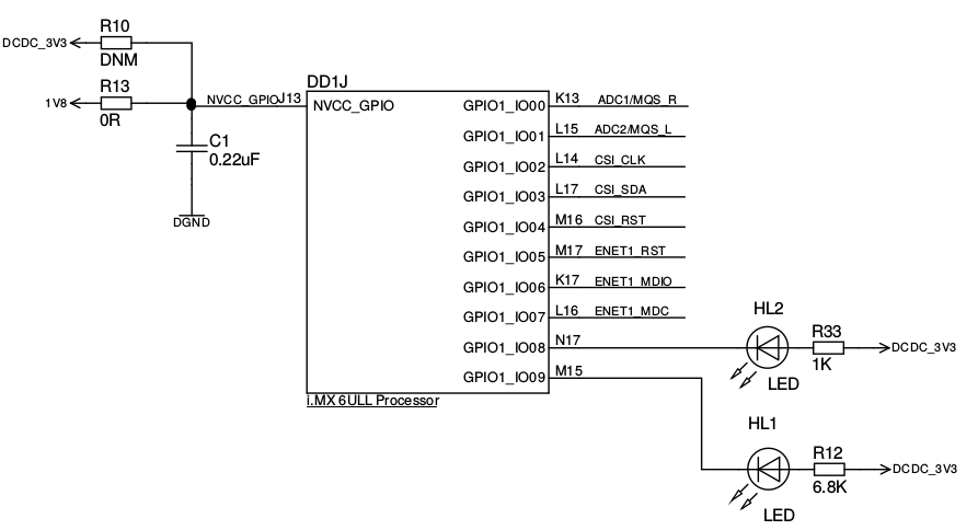

Dear experts,
We have a custom iMX6ULL board on an m2 form factor. It is plugged to a MAIN board which contains the DP83825IRMQR eth phy chip, the magnetics, and the eth port. The ethernet chip uses an external 25MHz oscillator for clock.
The problem we are having is that the network connection of the ethernet chip flaps (turns on / off)

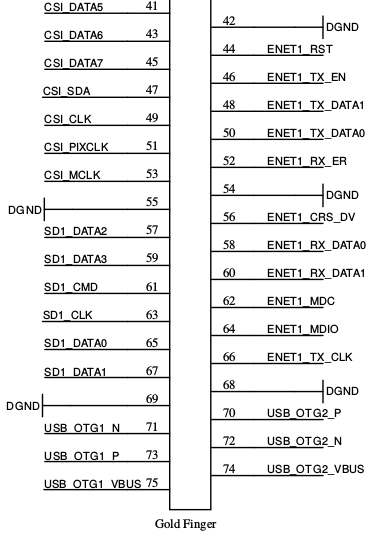

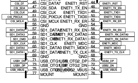

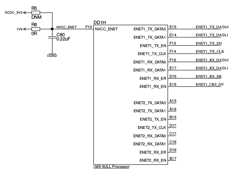

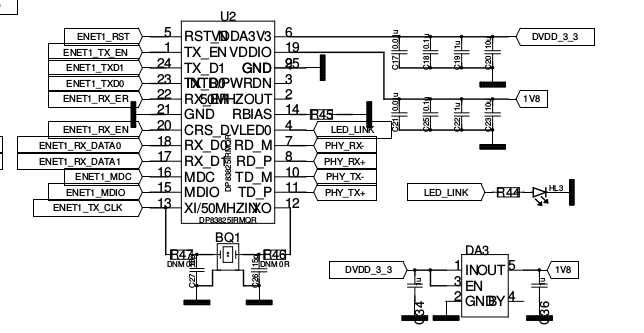

The connection of the DP83825 to the MAIN board is (sorry for the overlapping texts)
and to the m2 connector
While the connection on the iMX6ULL m2 edge finger is
to the iMX6ULL chip
Our device tree script in u-boot is imx6ull-prox-sodimm.dts (attached)
