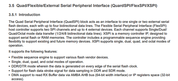

Hi mk:
QSPI driver is described in section 3.5 of Linux Manual.
i.MX Linux Reference Manual
