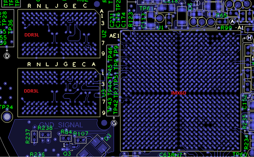

I have made board with DDR3L design using 32bit, I have done routing with Fly-by topology but I have not added bus termination resistor in my design.
Can you please tell me what will be the effect on the board and how can I solve this issue?

Typically, if no more than 4 memory chips is used and the PCB traces impedance is matched to 50 Ohm for single-ended signals and to 100 Ohm for differential pairs, the VTT termination is not required even when using the fly-by topology. In other case, the only way to fix the possible DDR bus issues is to redesign the PCB layout to add the VTT termination circuit.

Hi Artur,
Thanks for the reply.
I have used 2  x DDR3L - 16 bit (Total system 32 bit) with Fly-by topology. And both are on TOP side only.
Please see attached image for your reference.
It means that my design will work without any issue though I don't kept bus termination resistors.
The fabrication of oard is done and it is in assembly preocess.
Mrudang

Most likely, it will work without any issue.
