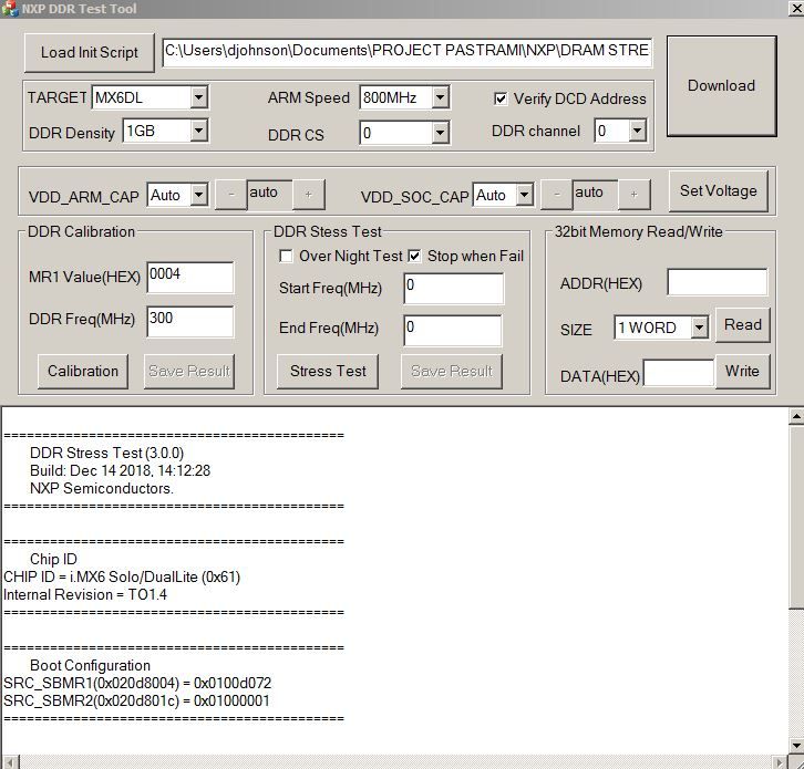

However all the required voltages are present in our case. We're using both 24 MHz and 32.768 kHz external crystals. The clocks look clean at around 1.1 Vpp. We're using two 4 Gbit DDR3 chips from Alliance operating on 1.35V. Along with the NXP iMX6 Solo processor we are using the NXP PMIC MMPF0200F6AEP. The DRAM_RESET pin is high (1.35 V). SDCKE0 and SDCKE1 are both low. DDR_VREF is 0.68 V (comes from PMIC).
Here's the test tool window:
Below is the text output of the tool after downloading the .inc script and then running the calibration:

Since we can't get by the "simple" leveling routine, there must be something obvious that we are missing.

First, please do not run the DDR calibration routine much below 333 MHz.
I would recommend a setting of 350 MHz to start out with.
Please let the DDR Density setting remain at default.
Finally, set the Write DQS and Read DQS values at 0x40 for all four channels and write leveling at 0x1F and run the Stress Test a couple of times without calibration. Please report the results. Maybe there is some clue in the failing results that might help us. It looks like lanes #0 and #1 are working fine, but the other two are having problems.

 We've been trying different things with the tool and we ran across this: change the bus width down from 32 bits to 16 bits. Include your previous recommendations. Select iMX6DL in the DDR test tool. Download our new .inc file (attached) that reflect the 16 bit bus width. Let the tool pick the ARM clock speed as well as the memory density. See below:
Run the calibration...it succeeded at 400 MHz every time but some times it fails at 350 MHz...strange! See attached log file. Ran the stress test at 400 MHz. Passed!!! See second log file.
