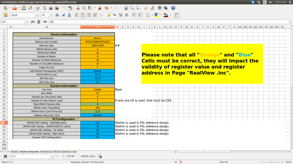

We have a custom board for which we refferred SABRESD reference Schematics.In our Board we change the RAM to Micron MT41K256M16TW-107 DDR3 RAM.We have two variants of custom board ,in which one is running on i.MX6 solo with 1GB RAM and another with i.MX6 Dualite with 2GB RAM.
I have done the DDR calibration for both the boards but I have following issues:
1) In solo board I am getting only 4 values from calibration(I have done the calibration multiple times).
2) After looking into others DDR3 configuration I modified my DDR3 configuration for solo but I am getting kernel panic issues continuously.
Is it necessary to run the DDR stress Test for setting up DDR3 settings properly?
I this script I am not getting Data rate option as 1866 (its lasts to 1600) and also I am unable to edit  tRCd ,tRC,tRAS values.
Do I need to change Si configuration values?
Kindly help regarding this issue.

Q. Is it necessary to run the DDR stress Test for setting up DDR3 settings properly?
A. Yes.
Try the script attached. All fields are editable there. For Data Rate options of 1600 and faster use the 1600 value.
Also, refer to the following community thread:
https://community.freescale.com/docs/DOC-94917
Hope it will be helpful.
