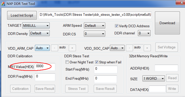

Q3: the last one about NXP DDR Test tool , What is the Value about MR1 Values(Hex)?

Yuri
   Customers can use the following tool:
“i.MX6ULL_DDR3_Script_Aid”
https://community.nxp.com/docs/DOC-333791
MR1 value should be the same as in the initialization script.
Yuri.

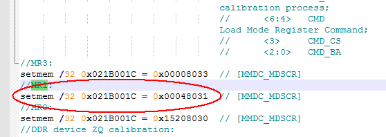

guochgz
Thanks Yuri.
"MR1 value should be the same as in the initialization script." What does this mean?
I have found this in ddr stress tools dir.
so MR1 Value should be 0004?
2,920 Views
Yuri
Correct - 4.
~Yuri.
