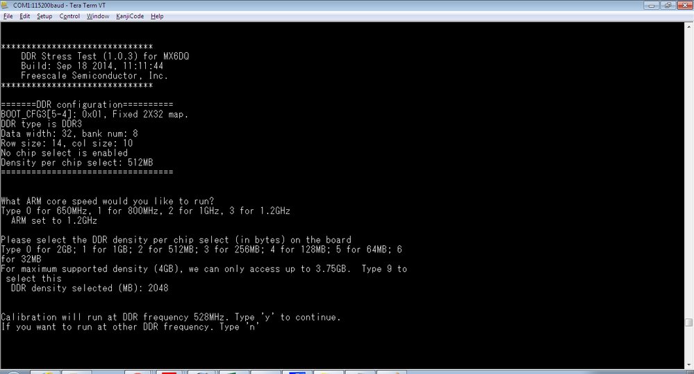

We are working on a customized board based on iMX6Q sabre lite board. We are trying to initialize the DDR3 and unable to access it via JTAG.
We used the DDR Script Aid tool, generated script file for the MT41K256M16HA-125:E DDR3.  When we ran the DDR_Stress_Tester_V1.0.3 tool, the stress tool was able to load the code in iRAM (Internal RAM) but after that, it couldn't continue the test.
The DDR_Stress_Tester reports the error message "Failed to reopen the device". We couldnt find much documentation about this error.

In the sabrelite board, we ran the DDR Stress tester tool V1.0.3 via USB and it ran successfully.
But, when we ran the JTAG version, we see the DDR Stress tester tool is not executing after the step where we select the DDR Frequency.

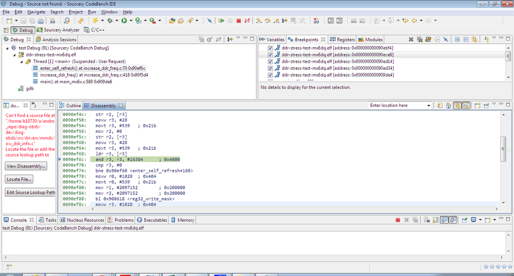

When I pause the execution, I could see the disassembly pointing to enter_self_refresh function and it never comes out of this function.
I have attached the snapshots for your reference as well. Is there any special setup requirement for JTAG version?

In the meantime, we ran the DDR stress tool in the sabre lite and observed different behavior when using USB OTG port and JTAG port.
We would like to know if there is any setting to run the DDR stress tool properly via JTAG.
