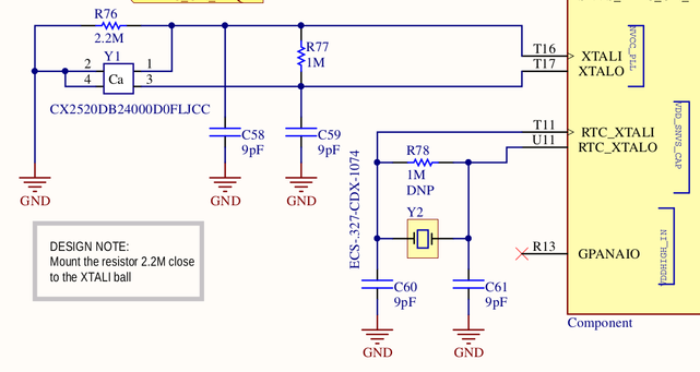

In our design we have 32kHz and 24MHz crystals. I checked both signals.

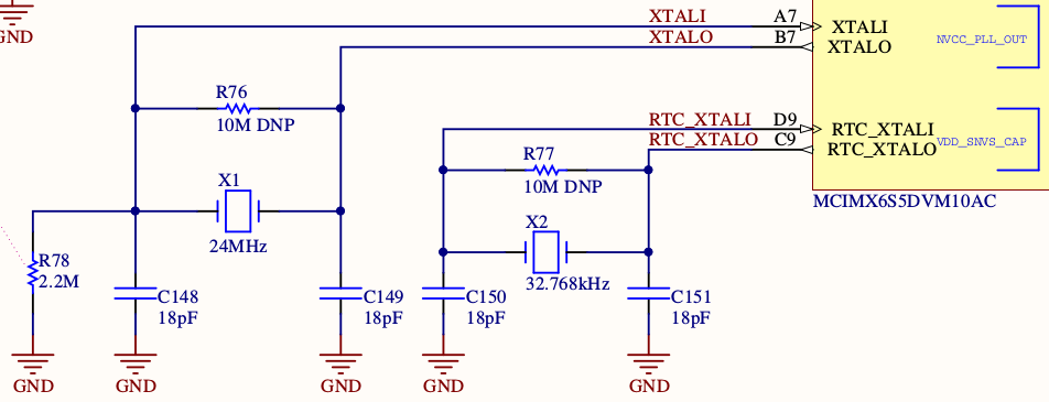

I checked RESET_B signal on oscilloscope and found that is never goes to high so memory is always in reset state.
