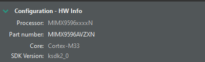

3,716 次查看
simonng
Hi @pengyong_zhang ,
I didn't change the LPDDR5 configuration. I am using the NXP IMX95LPDDR5BB-19 EVK board.
I tried to load your ds file but still the same error. Could you help to check my board configuration?
3,736 次查看
pengyong_zhang
hi @simonng
Please do not use the old version configuration to the latest version.
Are you sure your Config Tool version is V16.1? Because my v16.1 is different with your ConfigTool_v16_Error.png. Please double check it.
And i run the DDR test on my i.XM95 board, there is no issue occurred.
B.R

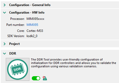

3,720 次查看
simonng
I re-installed V16.1. The error is the same. Please see the attached.
Could you share your config file (.mex) to me?
Thanks.

3,729 次查看
simonng
Thanks for your reply. I understand that the Config Tool can support i.MX95.
I can use the REV 15.1 to run the DDR Test on the MX95 EVK board.
But I found problem when using the latest REV 16.1. I tried to load the configuration that I used in REV 15.1. Also, I tried to create new project in REV 16.1. Neither one can work.
I attached the error screenshot.
By the way, I want to know if NXP is going to add the support of i.MX95 to the DDR Tool.
Thanks for your help.
