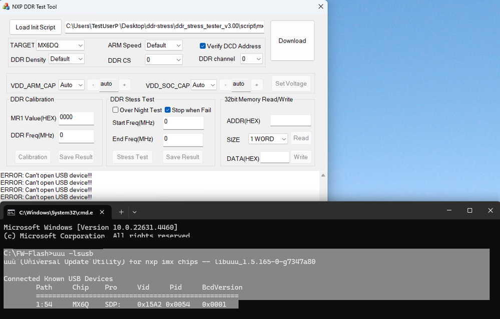

I could could not get the DDR Test Tool to connect to the USB Device. It is set to serial boot, and I can down uboot and linux using uuu.  However, DDR Test Tool kept giving me ERROR: Can't Open USB device. The following are the setting
* Connected to USB OTG
* Configure to Serial booting (I even verified that uuu can detect usb otg)
* Loaded init script EVK_IMX6ULL_DDR3L_400MHz_512MB_16bit_V1.2.inc
* Select TARGET: MX6ULL
I wonder if I missed any steps

I have ran it as admin, also as you can see its detected by uuu tools. but still the usb cant be openned by DDR Test Tool. Any idea?

hamzehnasajpour
I have the same issue with my imx6q custom board.
1. the boot mode is set to `01` Serial Downloader.
2. It's recognized by Windows and listed in the devices. I can see it in the list by uuu -lusb command.
3. I can send the uboot by uuu tool.
4. But when I am trying to run DDR stress test I get:
Any idea?

Hi Tan
one can try on different PC, also please try first power-up
board then attach usb cable to computer. May be useful below presentation
showing usage ddr test step by step
https://community.nxp.com/docs/DOC-331528

tanly
Hi Igor,
Thanks for quick reply.
Actually, I found a problem on one of my machines.  I did try on a desktop PC and a laptop, both didn't not work.  However, I found the virtualbox that I use for debugging uboot using the USB-OTG debugging for IMX, seems rename the usb drive in windows to virtualUSB, and DDR Test Tool does not seems to like it.  When VirtualBox was closed, DDR Test Tool was able to detect USB.
However, I still don't know what was wrong on my PC, but probably something similar or driver related.
Tan
