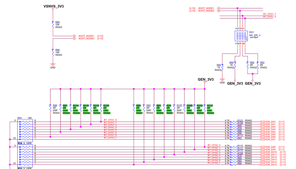

1. the boot config resistor:
   the green marked resistor is removed;

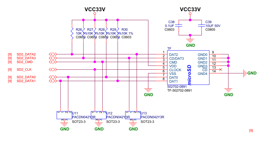

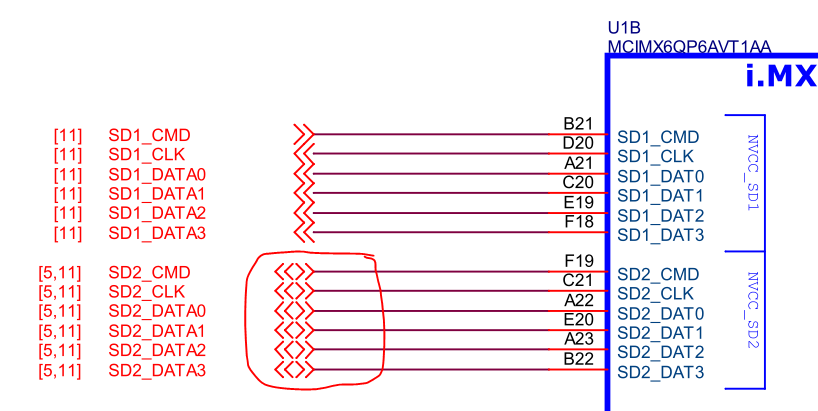

2. the SD2 interface:

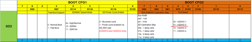

in this condition the BOOT_CFG1 and BOOT_CFG2 are configured as below.
all the power supply domain works fine, i checked one by one by Oscilloscope, it meet the power up sequence very well, as i expected, once i power up the board, CPU will boot from SD2, and i should see the SD2_CLK in scope, but there is no waveform at all.

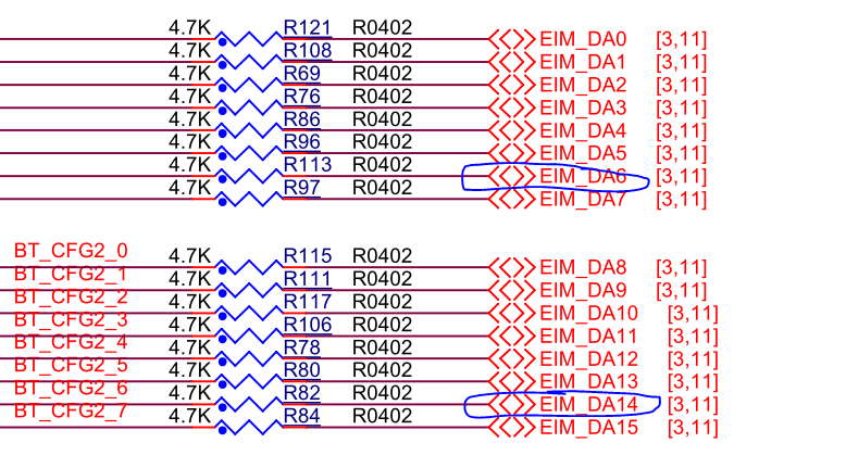

i guess the BOOT_CFG1 and BOOT_CFG2 configuration IO voltage might be in wrong level, so i checked EIM _DA6 and EIM_DA14 voltage during power up, it seems the voltage is low, can not be pulled up by the reisistor.
it means the all BOOT_CFG1 and BOOT_CFG2 are 0, that's why it can not boot from SD2.
i also check these 2 pins, it seems that they are output during power up, is it NorFlash interface boot here?

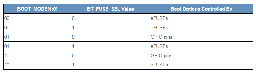

i searched in internet, and somebody told it's about fuse, i also checked the fuse initial value of BT_FUSE_SEL is 0 as described in i.MX6 reference manual 3.8.1.
the BOOT_MODE is 1:0, and BT_FUSE_SEL is 0, so CPU should boot from SD2 by GPIO pins configuration.

for BOOT_CFG1 and BOOT_CFG2 boot connections please check
i.MX6Q Sabre board schematic spf-27392 boot page p.21, SW6 switch

i did check the schematic you refered, i also design the customer board according the SabreSD design, the BOOT_MODE is 1:0 as i checked with multimeter, the voltage is right.
and for BOOT_CFG1 and BOOT_CFG2, my configuration follows below table, it's the same to the schematic as you recommand, system is booting from SD2.

then i checked BOOT_CFG1, CFG2 related pins real voltage during power up, i found EIM _DA6 and EIM_DA14 voltage are all low. but in schematic, i already pulled up to 3.3V.
i guess these 2 pins are in output mode, not input mode, so the BOOT_CFGx are all in wrong status.
this is not correct, they are inputs
probably there is mistake in board layout, so these signals are shorted to other or grounded.
