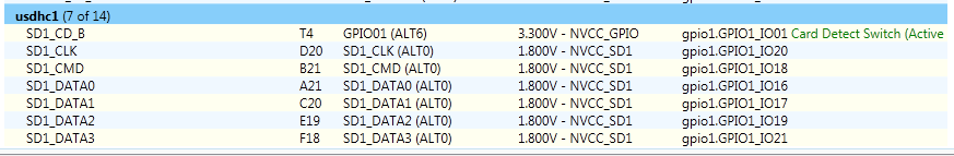

Thanks! I think my lpddr2 is working correctly now.  Next fire is trying to boot from the SD Card.  I am using uboot as the bootloader and putting it onto the SD card via
  • dd if=$FILE of=/dev/u-boot.bin bs=1k seek=1 skip=1 conv=fsync
I get no console response so I connected jtag up to see what is going on.  It doesn't seem like the IVT header is in 0x907400 nor is my dram initialized ( i do not even see a clock turn on when probing with a scope), so i don't think the DCD header is being run. I also connected the scope to the data0 line, command line and clock of the sd card. Upon reset of the card there is activity on the command and clock lines but i do not see any activity on the Data 0 line.
The sd card is connected to USDHC 1 with the following pads
The boot pins are set to: (and verified via console dump of 0x20d8004: 0x00012040)

I also try to boot the image via the mfgtool and see no activity there either (should the ivt be put into the same 0x907400 iram location too?) Also since i do not have a working kernel yet I dont know if the mfgtool would be helpful
  • Can i talk to the sd card via jtag?
  • Can i use jtag to initialize nand and save the uboot there?

I'm working with Rob on this: We do see commands going out from the SD card controller, and the SD card responding, but we see no toggling of data. Is there any other card formatting that needs to be done? When Rob created the SD card image we read back the first 50K into a file to verify that the IVT appeared at the correct 0x400 offset.
Another tack we're attempting is to load our uBoot image into DRAM with JTAG and then execute it. We are able to download the image into the DRAM, we set a hardware breakpoint to the first or second instruction, set the CPU to ARM mode, then resume to the "_start" address. We never trigger the breakpoint, and when we halt the processor it is program counter is still in the internal ROM of the iMX6. Is there a register that needs to be turned from JTAG on so that the CPU can read the DRAM?
