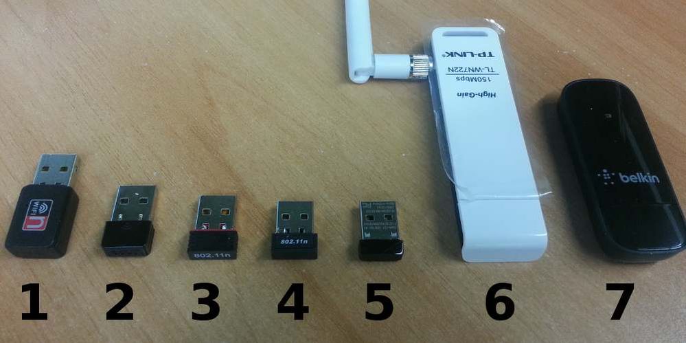

I have been working on a i.MX28 EVK development board, i needed to achieve to set an Access Point with the board and I had some dongles to do it:
     ChipsetDriver
1 & 2RT5370RT5370STA
1 & 2RT5370RT5572STA
3RT7601MT7601USTA
4RT81888188EU
5RTL8192cu8192CU
6AR9271ar9271.fw
7R87128712U
Finally after trying a lot of combinations (several drivers, kernels, ltib.. yocto..) I got the Access Point.
I was only able to have it working with the WN722N dongle, AR9271 chipset, in linux-2.6.35 it gets the ar9271.fw which doesn't work with hostapd, in linux-3.14 fslc compiled with yocto it gets the htc-9271.fw and hostapd has no problems to set the Access Point.
I wasn't able to do the same with the other dongles neither with linux 2.6.35.

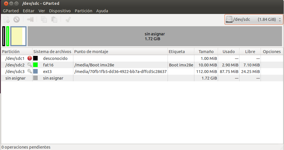

Impossible to boot... 0x8020A014 error --> ERROR_DDI_SD_MMC_DEVICE_NOT_SUPPORTED
I know that have to change "something" in the boot, but i don't know what and how, I tried to change the boot argument "setenv mmcdev 1" but neither this way, same problem.
These are the partitions of the card:
Maybe need to change something on the partitions?

In particular you need to blow some fuses, please look at Table 12-3. General ROM Bits
i.MX28 RM. You can check fuses on i.MX28 EVK with jtag and OBDS (stmp_otp.c test)
and blow custom board with similar settings.
When you don't have the SD card plugged into the slot (SSP Interface), the debug UART port
comes up with an error code 0x8020a014 which corresponds to "ERROR_DDI_SD_MMC_DEVICE_
NOT_SUPPORTED".
Blow the HW_OCOTP_ROM7 ENABLE_SSP_12MA_DRIVE bit
(to avoid TKT131240 SSP0/1-SD/MMC/eMMC Boot: SSP_SCK polarity setup issue in ROM)
Check fuse SD_POWER_GATE, when CARD_DETECT
goes low due to card insertion, i.MX28 firmware will drive SD_POWER_GATE low to connect
VDDIO_3V3 to VDDIO_SD. Remember to add 10K pull-up resistor on both SSP0_CMD and
SSP1_CMD.
