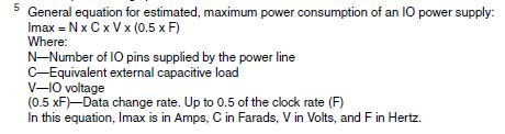

I don't believe we have any numbers for that, however from the datasheet you can see the estimator equation for the NVCC_ supplies is as follows -
Where the interface (F)requency of operation is one of the main factors in determining the current consumption, in deep sleep mode the interfaces should be static and F effectively 0, which means the current supply at that time should be limited to leakage only, may vary slightly depending on the number of IO associated with the supply in question.

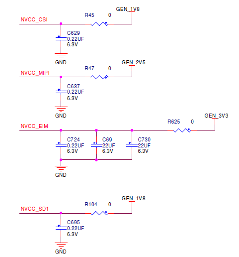

Our hardware development boards have some 0 ohm links that should make it fairly easy to take some measurements if required, see the SABRE SDB for example -

No I don't have any actual numbers for this, the theory states it should be minimal/near zero, if the customer is concerned can only suggest using one of our boards, as described above to take some measurements to get an indication of actual numbers, again if all interfaces are static they should all behave in the same manner.
